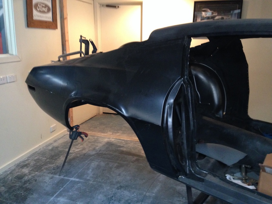

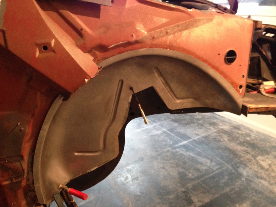

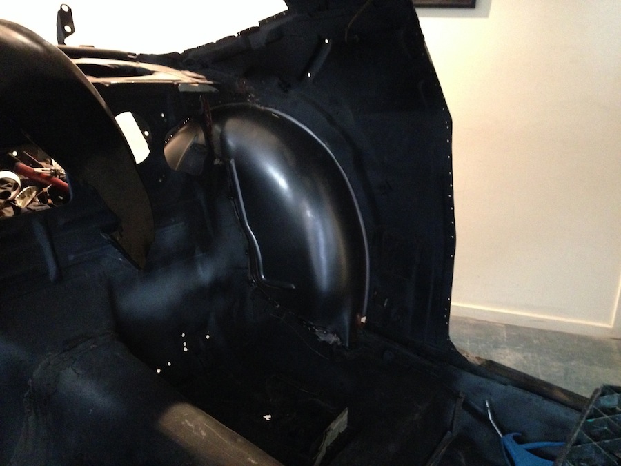

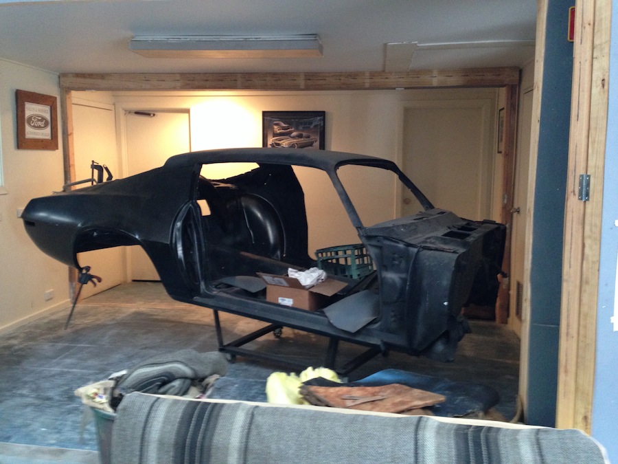

Well the boys did some construction work on the shop and built the Camaro it's own little room
Right quarter now on permanently, left quarter and drop off removed, left mini tub in place. going to look like a car again very shortly.
QUADRALink, Moser 12bolt, Vaporworkz tank, Magnum T56, LS9 Clutch have all arrived
Subframe, Kore3 Z06 Brakes and some smaller parts on the water now, due here in next 2 weeks.

Looking nice Rodger, what qtrs did you use? I need to maybe change (haven't decided yet) one of my, I just build a new lower section.
We used AMD quarters, panel beater was very happy with the fit.
All the AMD stuff has been a good fit. The only bits, outer cowl & trunk drop offs, that I couldn't get from AMD, had fit issues.

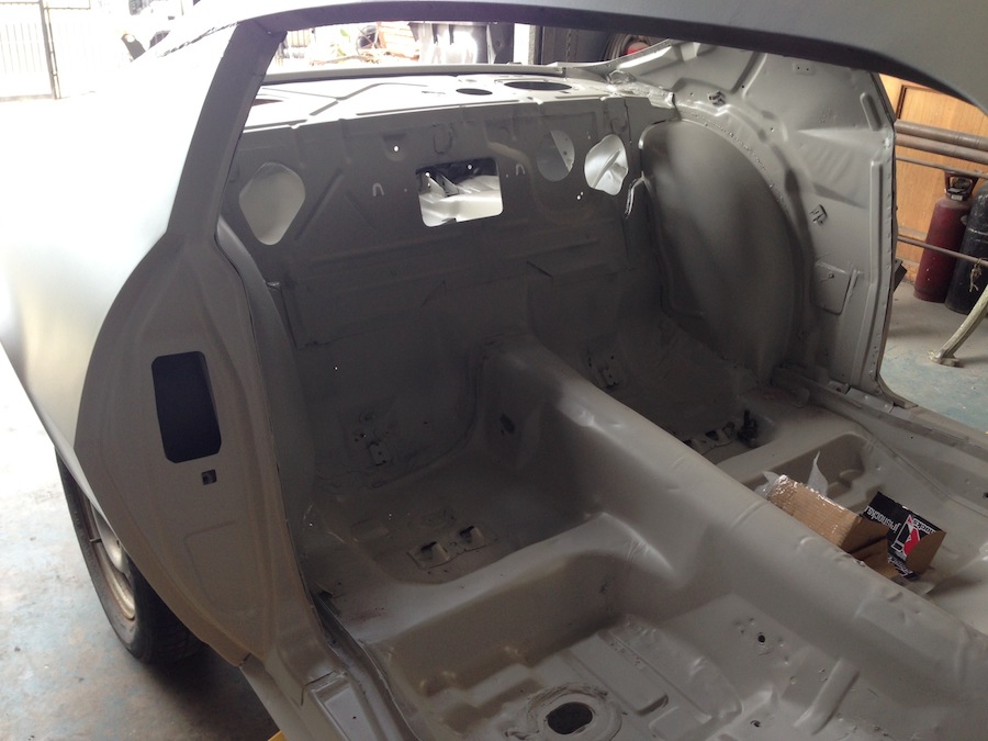

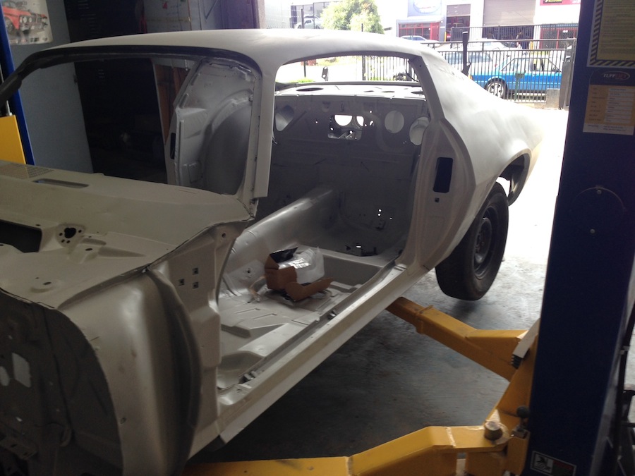

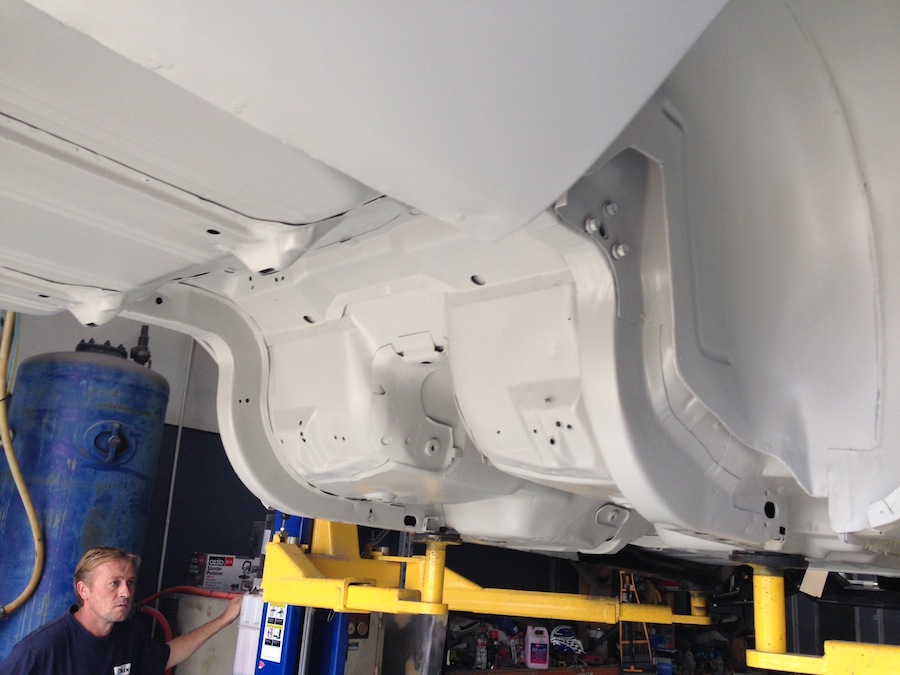

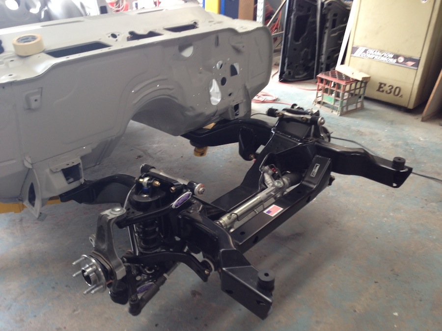

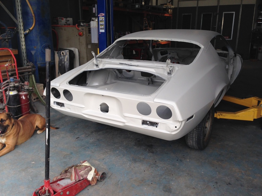

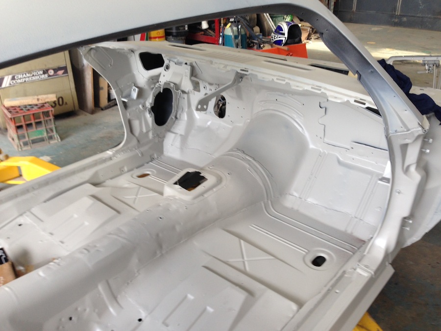

Well some progress. Body shell has all panels replaced and final welded, and is sprayed in epoxy primer.
DSE subframe also now fitted

Hopefully all front panels and doors will be installed, and it will go off for installation of, QUADRALink, diff, engine, transmission, subframe connectors. This will conclude required cutting to floor.
Then will continue with assembly for mock up.

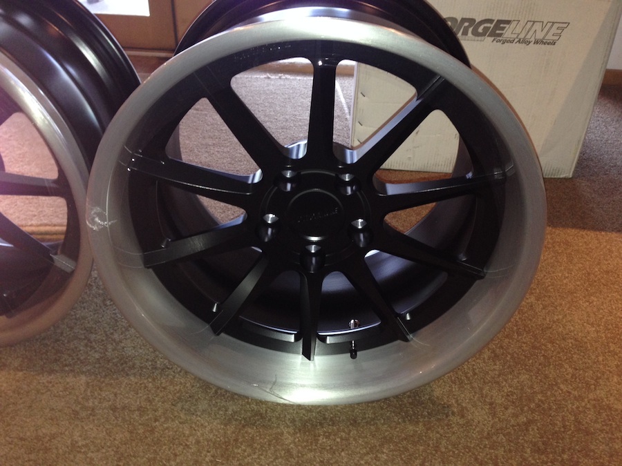

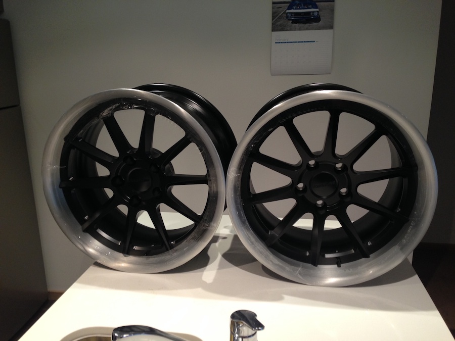

Also was able to collect wheels from shipping company yesterday.
Forgeline RB3
Front - 18 x 9.5" with 5.875" backspace
Rear - 18 x 12" with 8" backspace
Satin black Centre with brushed hoop
