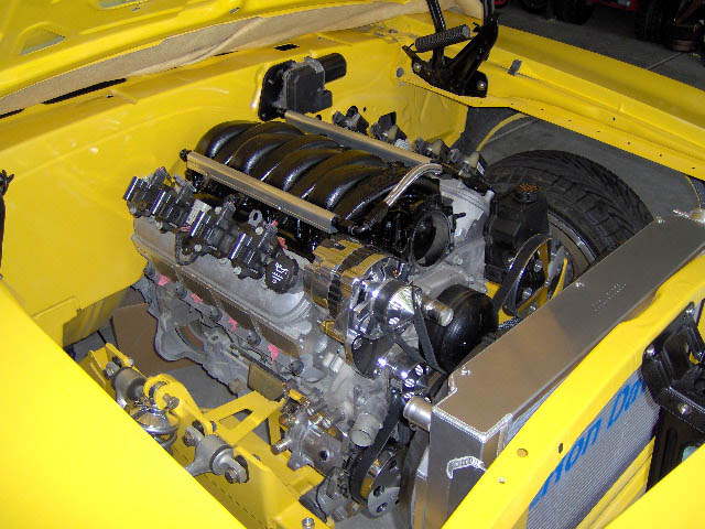

Payton asked me to post pics of his setup:
My LS7 69 Camaro
