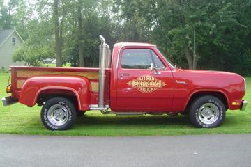

You should get this system...
SW
  #39
Old 04-11-2007, 12:27 PM
XcYZ's Avatar
XcYZ XcYZ is offline
Join Date: Jun 2004
Posts: 8,998
SW
LOL... maybe run side pipes, then shoot them straight up like that? I could put an H pipe between them over the roof and have an external roll cage.
