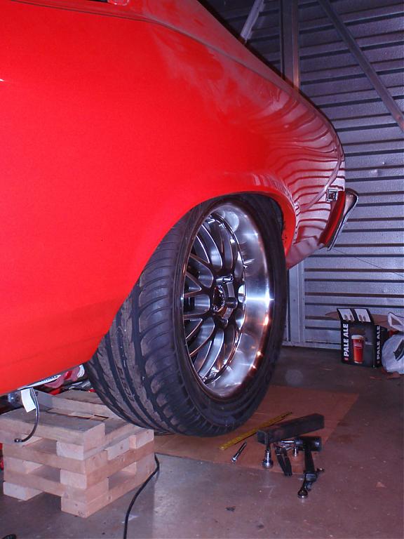

Here's a photo where mine sits now, with the shorter springs.

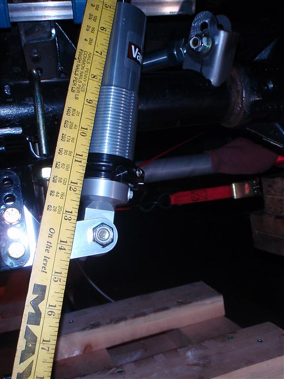

Originally Posted by Ron in SoCal View Post
^ My Strange (brand) shocks do the same thing. Freaked me out the first time I jacked up the car. Good idea w the safety wire Todd...
I saw same on my Strange fronts and Varishock rears. One of the things I really like about swapping all 4 to the RideTech coilovers - the collar does not have that freak-you-out-might-fall-out notch. Plus with the built-in, tapered rubber "bumper" they just seem to find home everytime as well. (Can't tell you the number of times I've been working on the car and the previous setup would "click" back into place a minute after lowering the car - scarred the bejesus out of me lol!)
As Todd says - should not be an issue under most circumstances but the safety wire is a great idea for sure. Plus, it is my understanding that coilover spring adjustment is designed to be for pre-load, NOT ride-height adjustment but you will rarely see that behavior around here lol!
Gregg

My rear springs will support the car with 0 preload. I have changed over to a stiffer hypercoil spring. The 12" alston spring did need a bunch of pre load. You definitely don't want that collar popping on and off of the shock body. That won't lead to anything positive.
Gregg
You can get helper springs to take up the slack. They are made from flat stock have a very low spring rate and only decompress when the suspension is not loaded. Eibach makes them among others. You also need a collar that installs between the two springs. I had to use them on my Art Morrison subframe to get the ride height I wanted without worrying about the springs falling off the perch.
Here they are, the picture is not accurate:
http://www.summitracing.com/parts/EIB-HELPER250/
These are the collars:
http://www.summitracing.com/parts/EIB-SPACER250/
A pricey solution but one that guarantees safety.

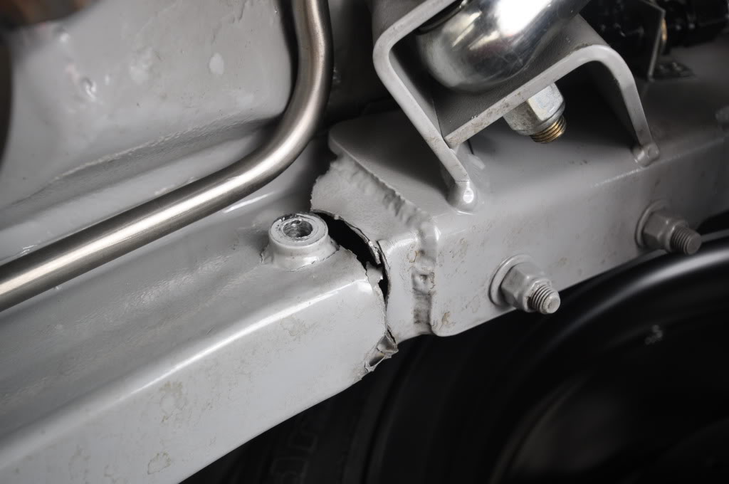

Originally Posted by DETON8R View Post
Got photos of those cracks? Or do you have a better description where they showed up? Was it for a mini-tub application, or was it in the factory sheet metal/frame rail?
I'm installing a G-link for a mini-tub application and I'd like to see where I might need re-enforcements welded in. I will be running a roll bar and supports into the trunk to spread the load around, so I should have a little bit more strength into the rear end section of the car than a regular bolt-in/weld-in installation as Chassisworks recommends.
I don't have any pictures yet, the cracks are still hairline. I already had the cradle welded in and at the paint shop before I heard that this was happening, so I've been keeping a close eye on it. It is mini-tubbed, 4 point roll bar and the frame rails are the flawless originals. Once the Autorama is over with, I plan on addressing this problem. If you go to Vegas69 thread probably page 230 something, Todd has some pictures of his and another Camaro that this has happened to. In my opinion it is a flaw in the design that can easily be repaired, just sucks if your car is already done and the underside has nice paint on it.
  #48
Old 11-24-2011, 10:07 PM
DETON8R's Avatar
DETON8R DETON8R is offline
Join Date: Jan 2010
Location: Scotts Valley, CA
Posts: 265
Thanks for pointing me to that photo. Thanks for that info. I've attached for others to see. I don't know that I'll knock my car around that hard, and I'll keep an eye on it when the car hits the road.

That's not mine but a g link failure. Mine was just cracked around all three sides.

Originally Posted by pokey64 View Post
Vince,
They're 12 200s now. I took a quick cell pic this morning of ride height with tank. I still need to throw some weight in the trunk to account for a sub box and full spare that Beth wants. We put around 300 miles on it this summer so it should be settled. I would like to get the tire tucked a bit so I'll probably be looking at shorter springs.
Todd,
Good info on what to watch on shorter Springs.
I'd get full weight and a few miles on them before you make the changes. But before switching to a shorter spring try a 150# or 175# 12" spring you should get a bit more compression out of it and still maintain a good ride.
