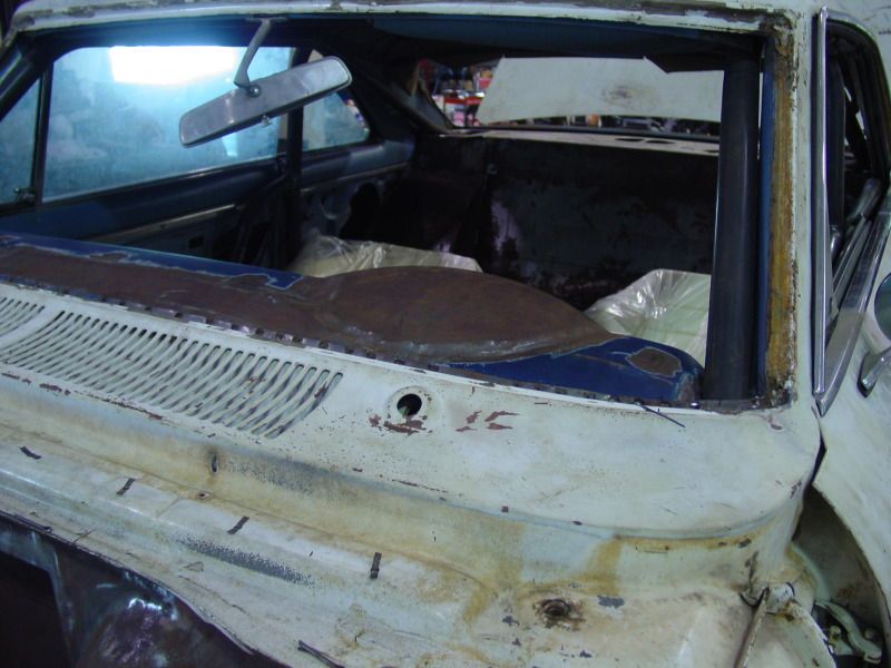

Where it started
All of the undercoating
Now its clean
