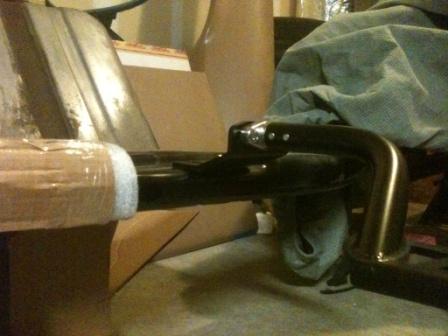

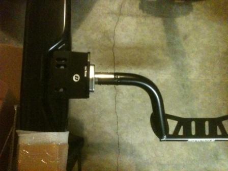

Gents,
I got the speedtech crossmember and despite it fitting the frame, the wierd "L-Brackets", go pretty vertical off the frame. This doesnt seem like it will clear the floor. Does anyone have actual expereince using this X-member and possibly photos?

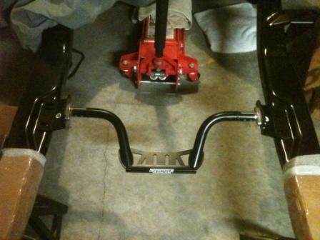

Posts: 334
Here is the 67-69 Speed-Tech X-member on my 70-81 Frame. Fits good, but the floor to bracket does not.
  #50
Old 12-14-2014, 06:07 AM
dhutton dhutton is offline
Join Date: Nov 2006
Posts: 1,948
Thanks: 1,244
Thanked 580 Times in 317 Posts
I think they are upside down.
