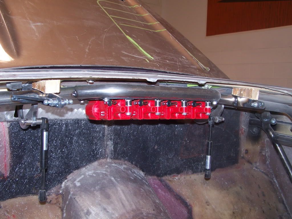

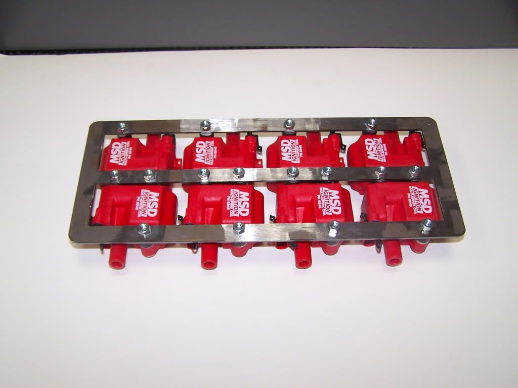

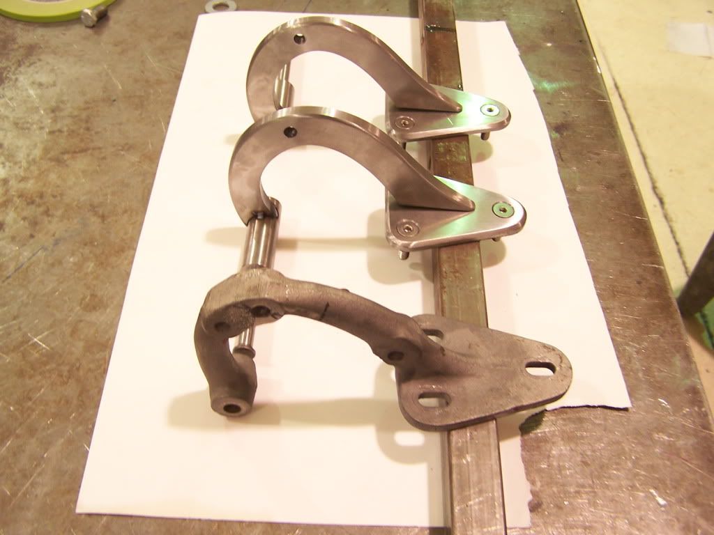

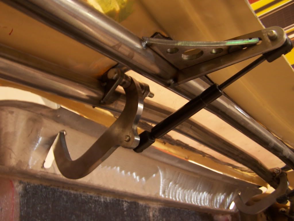

Coil pack mount
Installed under the dash
Designed new hood hinged so the hood hinges at the rear. Hinges and shocks go under the dash for a clean under hood appearance
Fabbed new trunk hinges as a clean version of the original.

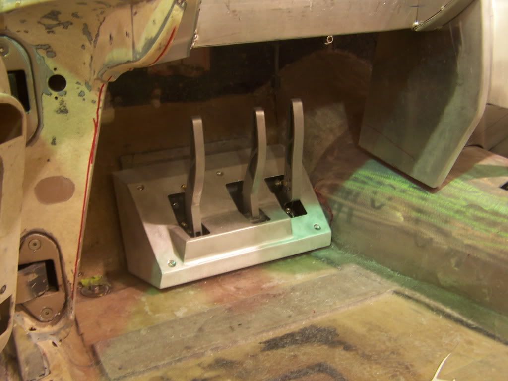

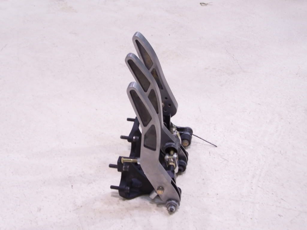

Pedal assembly
Installed in car with aluminum pedal box cover (Actual pedal pads still to be installed)

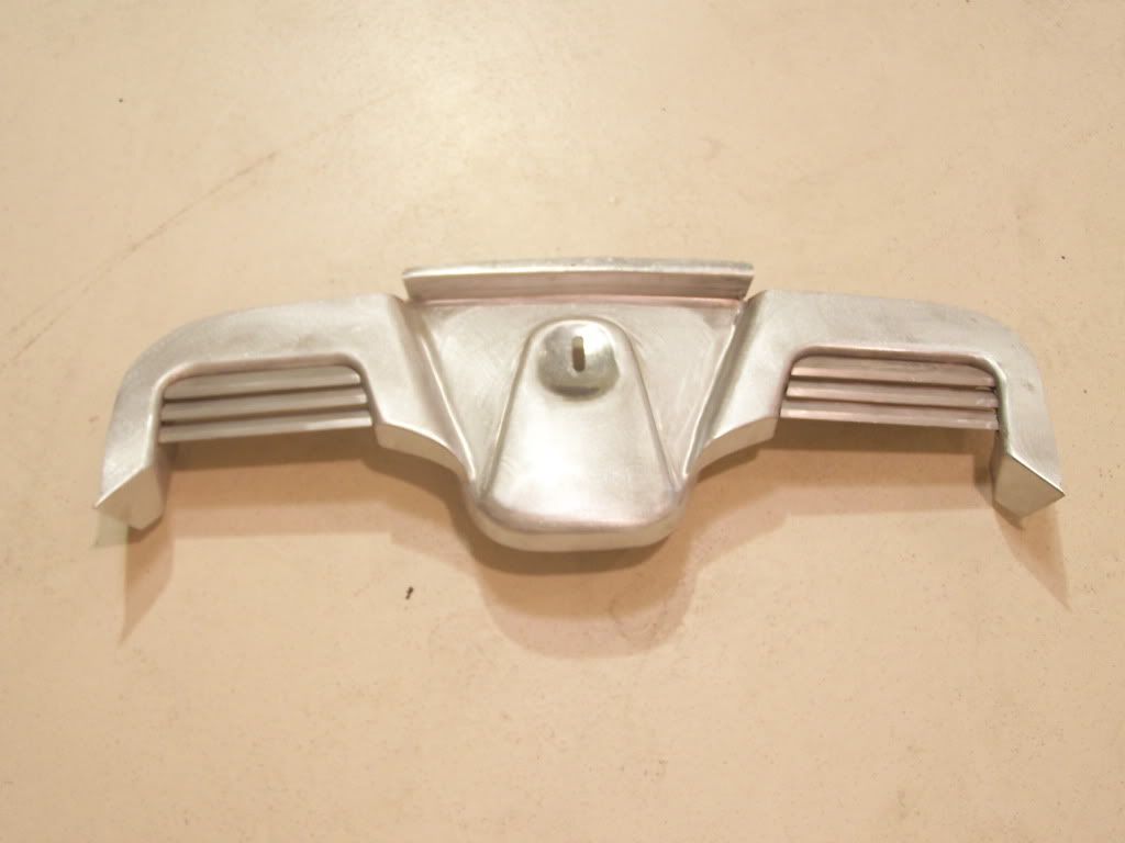

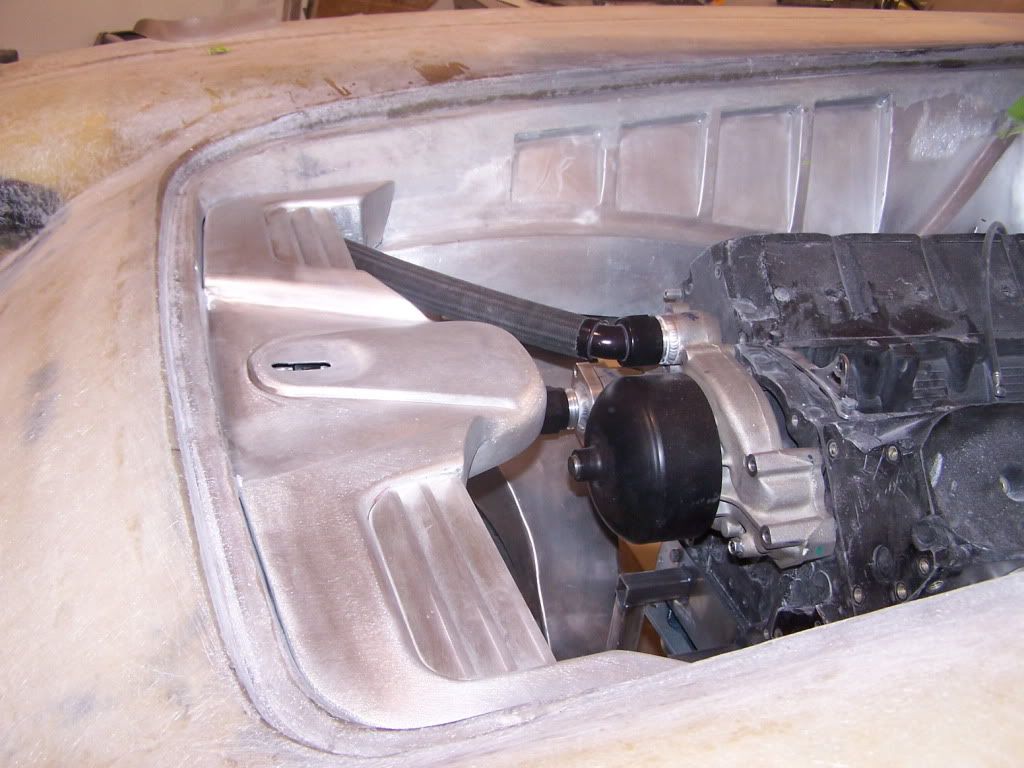

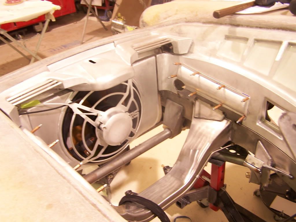

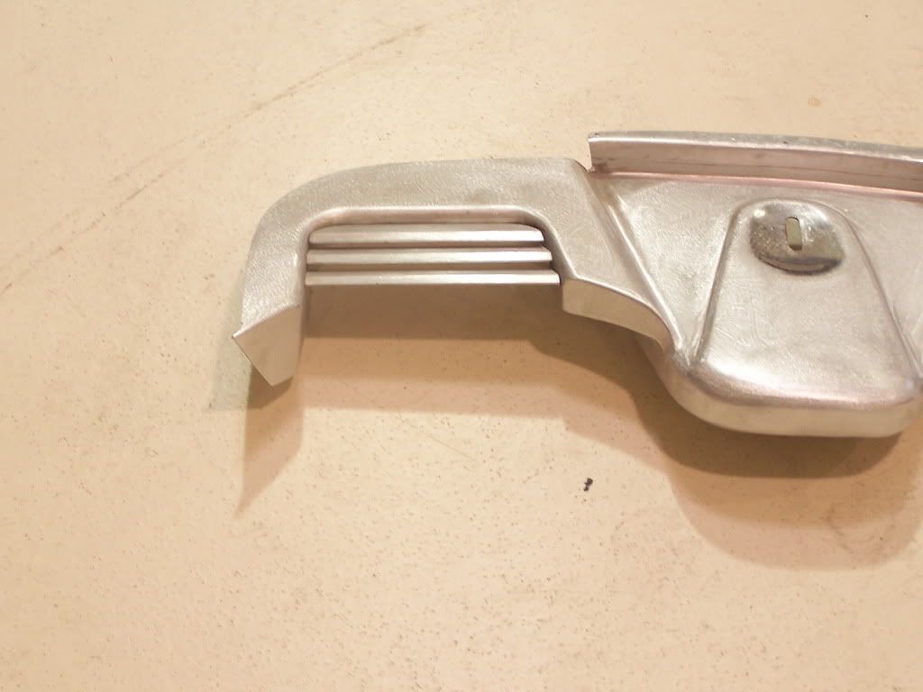

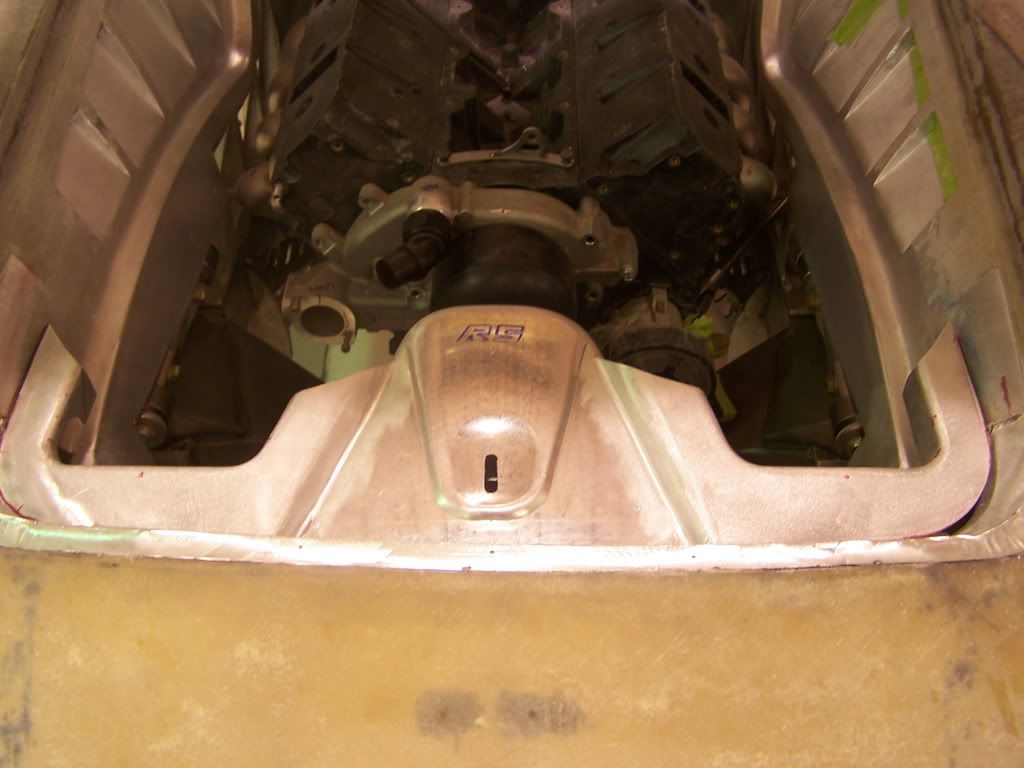

More under hood pics.
Aluminum upper radiator cover
Aluminum fab shroud completed and all aluminum panels fit to car.
