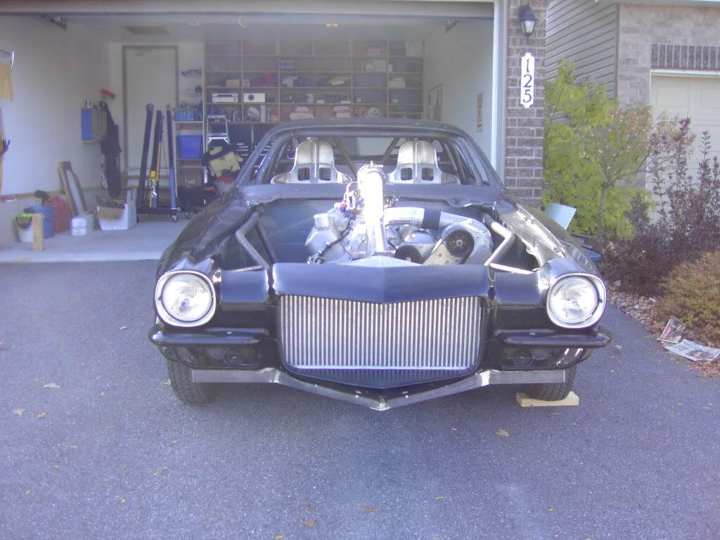

  #57
Old 01-07-2010, 02:54 PM
speedjohnston speedjohnston is offline
Join Date: Jul 2008
Posts: 411
Originally Posted by deuce_454 View Post
now i feel like selling everything i own, building a 502 with big heads and an f2... so thanx alot!!
what kind of transmission are you running??
The transmission isn't purchased yet. I have a few ideas I have been tossing around and I know what my #1 pick is but if something better comes along before I buy it I will get that instead. the tunnels is big enough to fit a turbo 400 and a gear vendor wich would probably be the biggest thing in there. When I do the purchase I will let everyone know but its still up in the air. Its just hard to get a manual tranny that can handle that much torque and be reliable so....
  #58
Old 01-07-2010, 03:03 PM
Join Date: Jul 2008
Posts: 411
Originally Posted by MarkM66 View Post
Looks great.
What are you doing for a radiator?
As far as rad or maybe rads in this case, I have talked with Ron Davis about making 3 to get them in the space I need them to fit. I'm going to try to figure another way, but to keep my intercooler where it is and get the cooling I would need for silver state I either change the lower tube on the intercooler or install multiple rads. There isn't a lot of room between the intercooler pipes.
  #59
Old 01-07-2010, 06:17 PM
MarkM66's Avatar
MarkM66 MarkM66 is offline
Supporting Member
Location: St. Louis MO
Posts: 1,962
Maybe you already said, but why didn't you have the inlet and outlet come out the sides of the intercooler?
That way there'd be more room for a radiator.
  #60
Old 01-07-2010, 06:31 PM
Join Date: Jul 2008
Posts: 411
The bottom one can be moved wich was what I was kinda indicating earlier, the top one has to stay. The top one coming out the side would mean lowering the intercooler to clear the hood and it wouldn't have the air that it will get now. I had some other initial plans trying to think outside the box, but if it doesn't work I will have to move that lower inlet. You can see in this photo how the intercooler is making maximum use of its 'big smile'. This photo was taken before I had the intake lowered so I allready have to have the upper tube changed.
