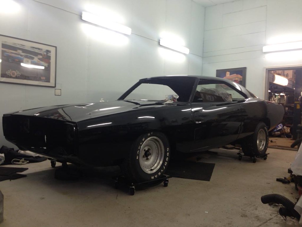

I´ve have been working my other -70 Charger this winter, pure streetcar but think that it can be skidded when done.
Currently fitting engine and gearbox...
