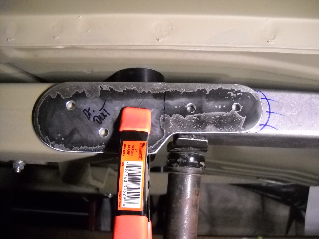

are ready to weld in! I had the local Metal Dist. cut out some brackets outa 0.125" and got them mocked in tonight, still need to trim the inside cuz the tranny crossmember is right there. I am going into my old work place and borrow their welder to get these attached to the connectors, needed some heat for .125".
Anyway, not very artistic plates .... but practical. Then I'll weld tubes in the frame to stiffen up the bolt holes.
I need to adjust the floor opening to allow the connector to mate to the frame in the same plane .... they are off about a 1/8" to line up, then I can weld em in finally!

Looking good Sonar. I heard you need to have the full weight of the car on the suspension with motor, seats etc. before completely welding the subframe connectors in or trying to align the holes to bolt them up. You might want to look into that. I'd hate for you to do all that work and have to redo it.

I just called and talked to DSE and they recommend to wait til I have the suspension and rear end in and measure the wheelbase before I weld them in .... didn't say anything about the build weight. Just said make sure its square .
It would seem difficult to weld the top of the seat mounting plate back in after re-installing the seats...? I do not see that in the instructions linked below.
http://www.detroitspeed.com/images/i...Connectors.pdf
An important tidbit pasted from the instructions... "If you have any questions, please call Detroit Speed at (704) 662-3272."
The weight in general needs to be settled on the suspension before welding the plates from the subframe to the subframe connectors. I'm not sure which seat plate your referring to but only a small square of the seat mount needs to be removed to install the subframe connectors.
