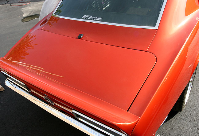

Nice. That's great color.

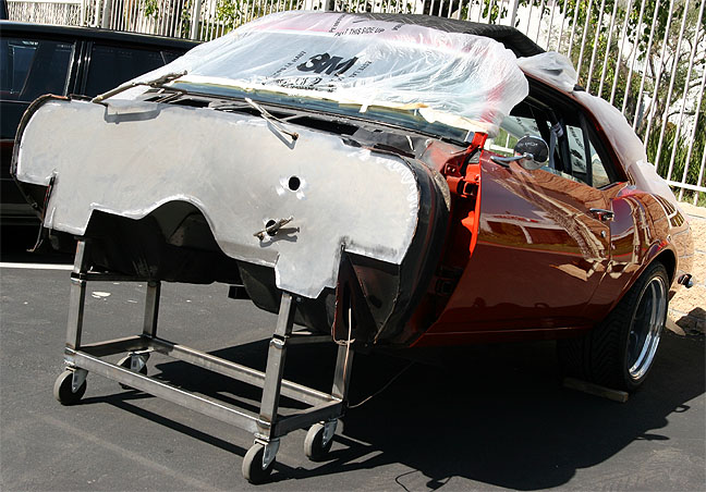

awesome update Steve!
I am really starting to think this car will be magazine material when finished! lol
That firewall fill plate looks killer! Keep up the good work

very nice firewall, can't wait to see more

Looks good! love that color too

Firewall is almost ready to be bonded and then welded. The holes are cut for the master cylinder and steering column. Not that I have my ATS clutch master and bracket we can cut that hole as well.
That's it.. only three holes in my entire firewall.. The new trans tunnel has been tacked in place and it is raised almost 2 inches at the firewall for T56 clearance. The pre-fabbed pieces from 21st Century made it a LOT easier. Next week it will all get bonded with the super epoxy and welded. Then the studs for my fly by wire throttle peddle will be welded on.
