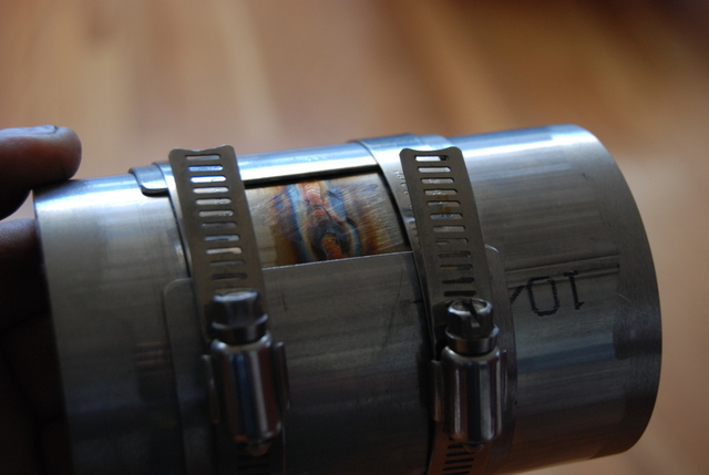

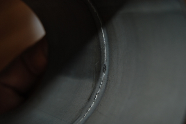

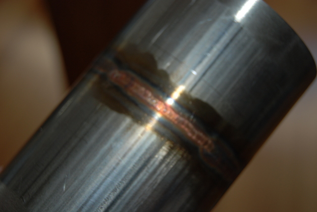

OK I tried with back purge today, I'm pretty happy, I think I need a touch more penetration.
I made up a tool to hold the pipes in alignment ready for tacking and that really helped.
Greg

Looks good Greg --- nice color -- not much if any sugaring..... You suck as a photographer though!
Nice, thanks Greg, It's a reasonable camera, but I have no idea how to work it.
I am running 20 on the back purge, do you think thats enough? Mr

Nah --- way too much ---- chop it down to about 5 CFH....
If you want to -- you can juice it up just to push the air out but then cut it way back down. Doesn't take much. It's really more about removing or displacing the oxygen (air).

I just had to poke fun at your blurry photo.... Dude! I want to see those stacks of dimes you're laying down!
