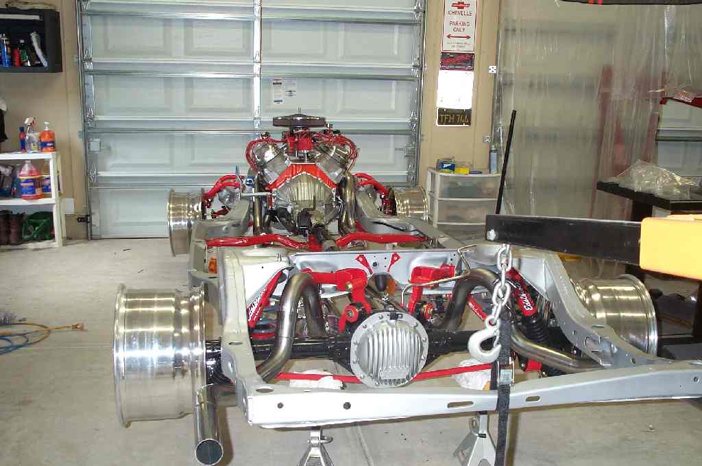

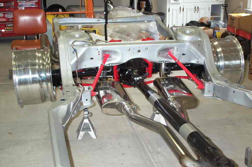

Project Plan - - Black Diamond (1969 Chevelle SS396)
Engine: Original to car 396 block and steel crank – everything else changed to get to C/550HP and 500lb TQ on pump gas built/Dyno’d by Mike’s Performance Shop Rocky Mount
Dart Pro 1 Heads; Aluminum Roller Rocker Arms; PBM Eliminator Hydraulic Cam; Weiand Xcelerator Intake; Mallory Ignition Box; MSD Pro-Billet Distributor; MSD PowerMaster Starter
Fuel System: 750 Barry Grant Mighty Demon; Holley Peformance Fuel Pump; Aeromotive regulator; Stainless Steel Gas Tank Rick’s Hotrod Shop Texas, Fram fuel filter at tank with Jegs filter at carb; Stainless steel gas lines by Right Stuff Detailing
Wheels/Brakes: Wilwood 13" 6 piston Superlite Drilled and slotted Frt; Wildwood Brakes - 12.2" 4 piston Dynalite Drilled and slotted Rear (GP Superstore); Stainless steel break lines – Right Suff Detailing; Energy Suspension bushings and body mount; 17” Budnik X-Series Mirage Rims (Detriot Speed & Engineering)
Transmission/Exhaust: Munci 4-Speed (M-21); Hayes Performance Clutch; Stainless Steel Hooker Super Comp Headers; Magna Flow 2-1/2” Stainless steel exhaust; Stainless Steel exhaust tips by Pypes Performance
Suspension: Silver powder coated frame by Top Coat Inc. Raleigh NC; Original 12 Bolt (3.31 gears) with Eaton Posi; KMA 1-1/8” Front sway bar ; KMA Rear sway bar ; Upper/Lower Rear Tubular Control Arms by UMI Performance; Tubular Upper/Lower A-arms by BMR Fabrication Inc; Moog Steering Components with Solid Aluminum couplers; Hotchkis F/R springs 2" lowr frt, 1” lower rear; Edelbrock Performer IAS Shock F/R; Mr. Gasket Aluminum Diff Cover with ARP SS bolts; Energy suspension bushings/body mounts; Suspension bolts by Wielder’s
Body – (South Carolina/North Carolina Car): Original Panels; All new weather striping and door felts; 2003 GM Black with Pewter stripe (DuPont paint system: Primer, Sealer, Base, Clear; Powder coated core support and front inner fenders; Aluminum radiator
Interior (Original Stock look): Leather Seats; Tilt Wheel: Gauges by Autometer; Original AM/FM Radio

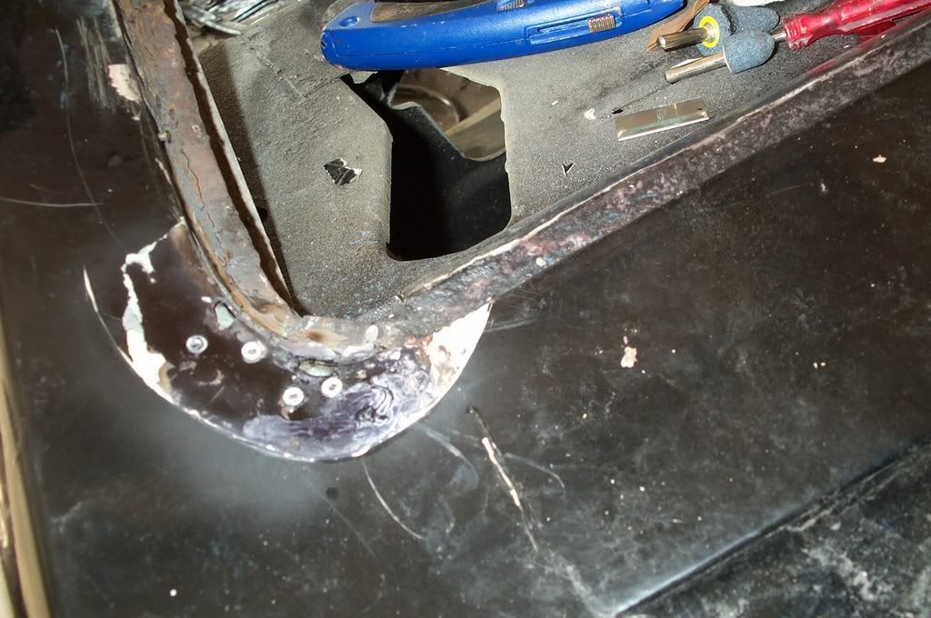

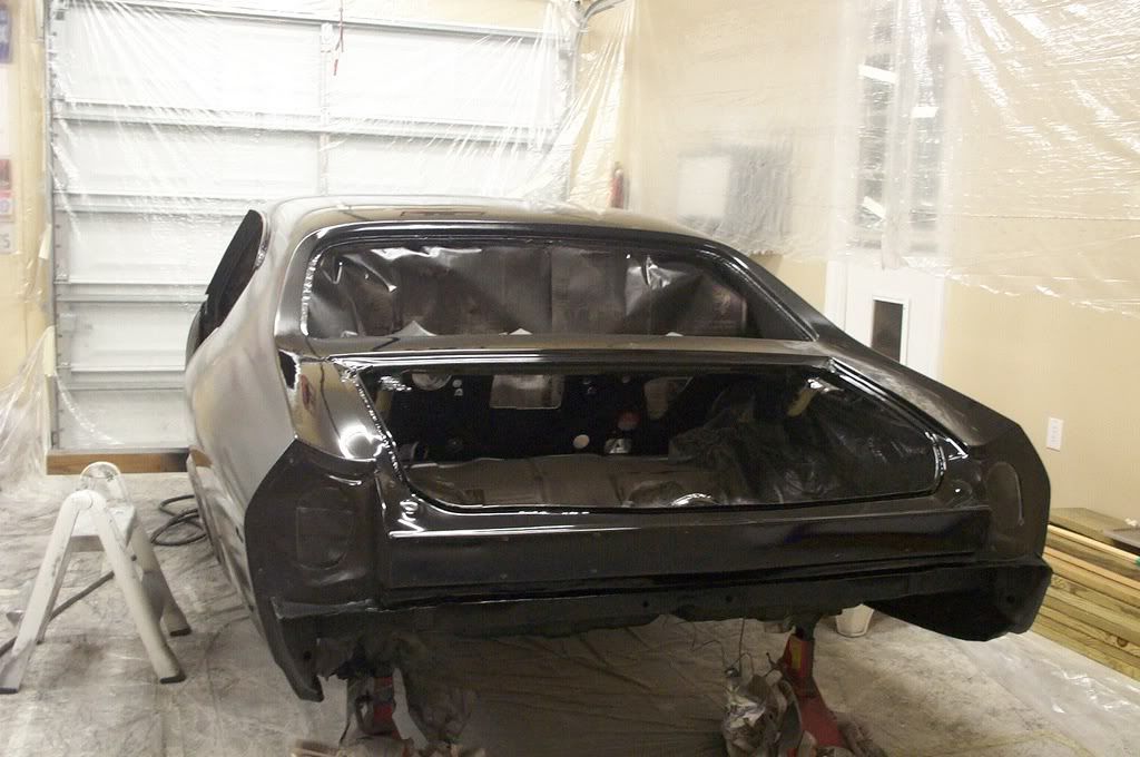

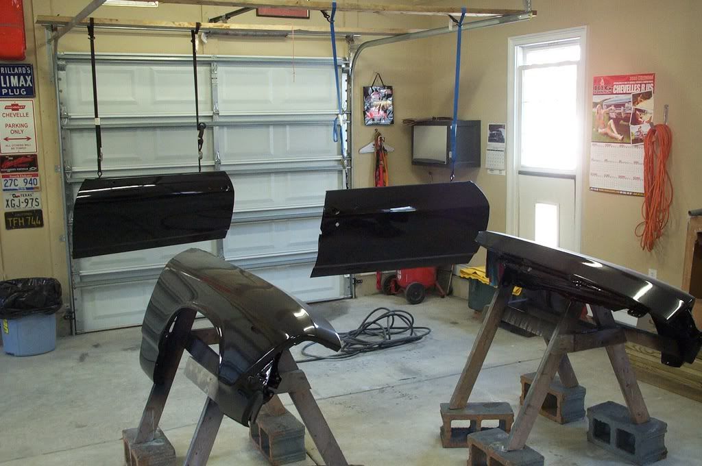

I'm through the stages of paint .. now I have to wet-sand and buff it out. Only the main body though ... still have the other pieces.

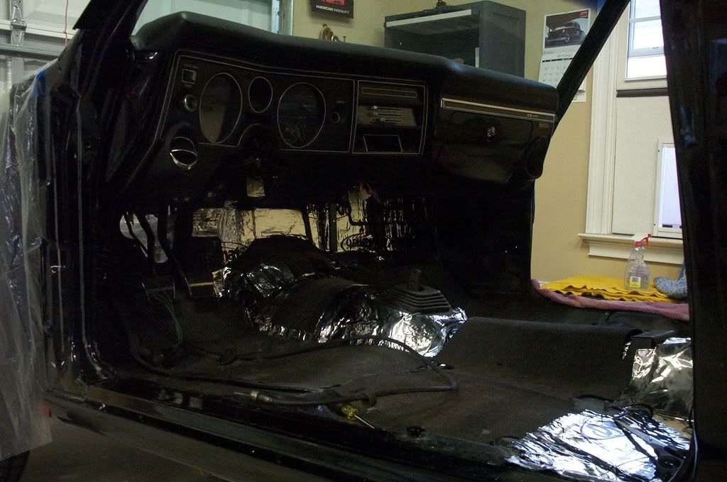

I had to repair the rear window area - a lot - as it was formally a vinyl top car, thus I elected to smooth the rear quarter seam lines. Since its still the factory quarters I took a little extra time improve the transition from the rear pillars to the roof, there is a natural bump from the factory where the rear quarter is seamed in, I'll even state I believe the passenger side is a little worse than the driver side out of the factory (at least on the 30 or so I've checked). Final picture is of the firewall; here I smoothed the firewall, I tried not to rush to much but its a tough area to get perfect. My goal is to end up with a clean and wire/hose free engine bay.
