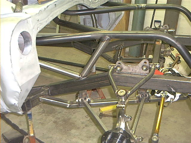

Here are a few of the front clip.Not how I normally build a car. But the guy insisted on leaving the cowl.

Tig man, can you tell me the size & thickness of the box tubing that you used for the lower control arms? I'm building my own and from the looks of it I have slightly thicker tubing but pics can be deceiving.

The ones pictured are .75 x 1.50 x .095 wall! Cup cars are normally 1 x 2 .125! I remade these lowers in 1" OD x .120 wall later on!!

25 x 50mm 4mm wall is what I'm using. I like the ones you built, they are clean looking.
