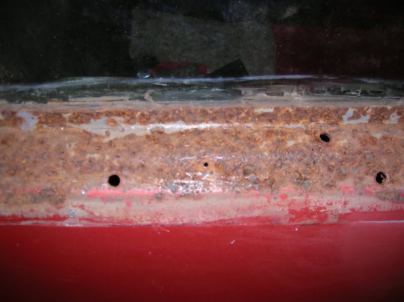

Here is what I found...

Hard to tell on my flintstones era laptop but it looks like you've got pinhole sized holes through the pass lower window area. Is it rusted through? Is the metal weak from rust?

I poked at it with a n awl and couldn't find any weak areas. The large holes are for drainage I think. The smaller ones hold on the fiberglass for the vinyl roof. I think I cand just knock off the big chinks and POR-15 it??

I'd take a Roloc Scotch Brite to it. It might clean up ok.

Yup clean it up as much as you can with wire brush, scotch roloc, or grinder and then por-15 then fill/sand/paint
