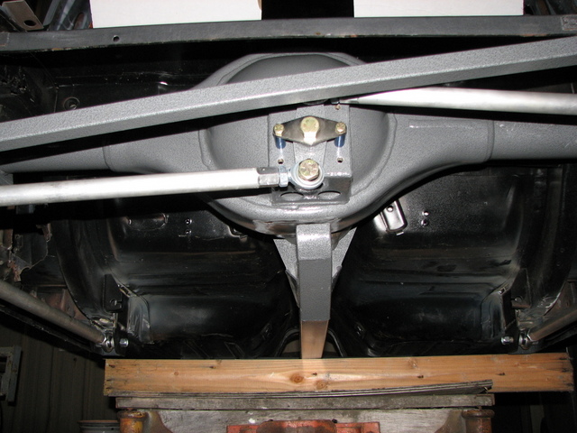

Posts: 155

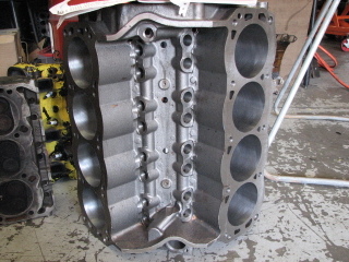

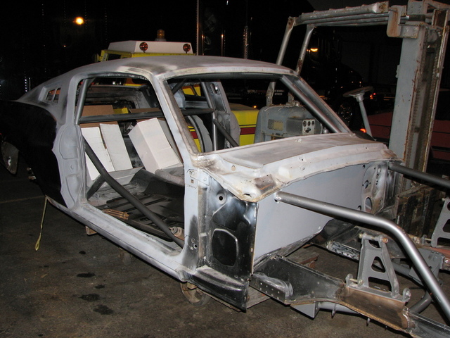

some pics

Posts: 155

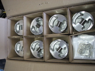

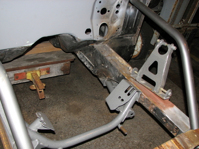

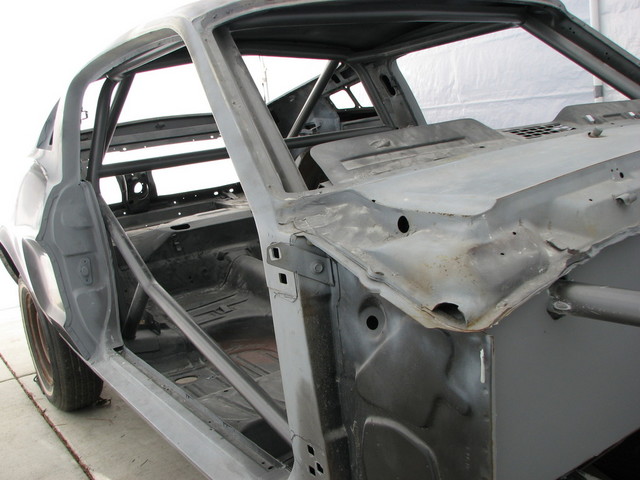

here are some more pics for u guys

My motor is being put together at Reedy's racing engines. Here are some specs:
Dart 351 windsor block 4.125 bore
trick flow track heat heads(ported)
edelbrock victor jr. manifold converted to fuel injection
Ross racing forged custom pistons 46cc dish
Scat 6.2" forged rods
scat forged crankshaft 4" stroke
