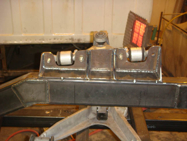

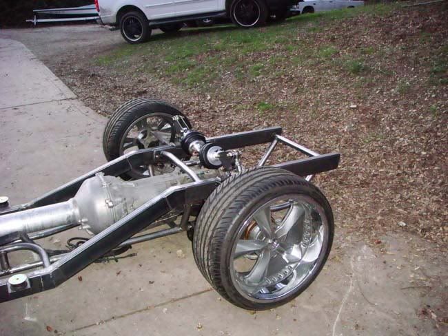

Hi everyone! I have been lurking around here for a while as a guest admiring some of your absolutely beautiful projects and rides. I finally decided to register and share my project with all of you guys. I am new to this kind of build so i am learning as i go. I orginally built a custom tube frame for my truck that utilizes the solid rear end and a LS1 motor but when i went looking for the motor i found an increadible deal on the entire c5 drivetrain so i decided to go that route. So i built a new frame to accomodate all the c5 drivetrain and suspension. I had to extend the torque tube to accomodate the longer wheel base. There are a bunch of other things i did but will let the pictures do some of the talking. I am hoping to have it driveable by this summer so i can make sure i don't have any bugs and everything performs well then it will be torn back down for paint and powdercoating. Enjoy

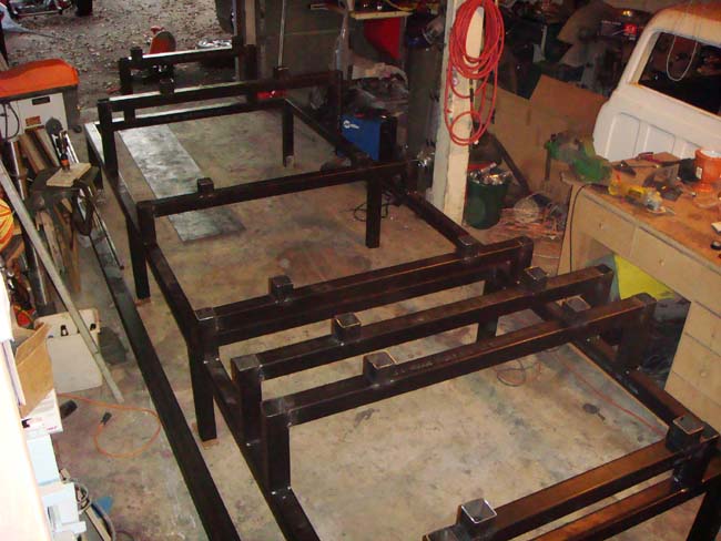

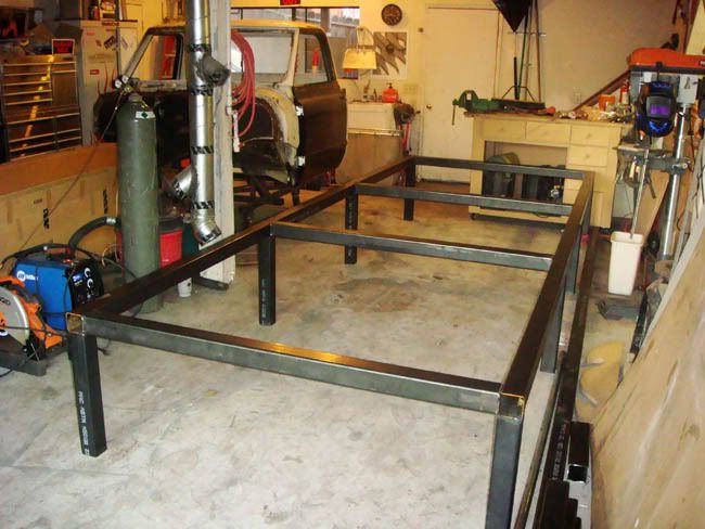

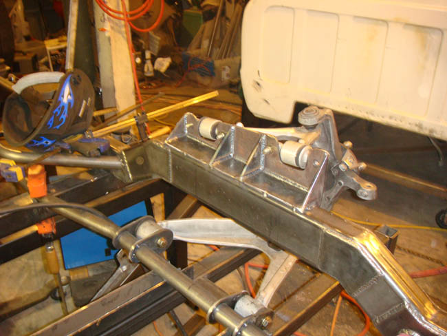

Here is the frame jig i made

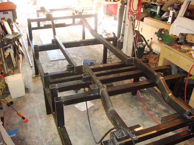

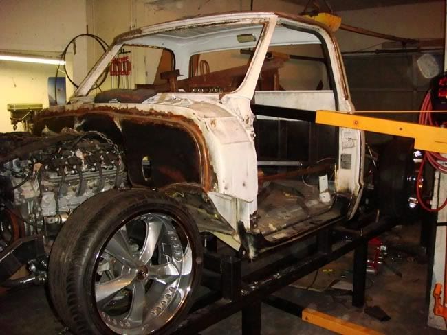

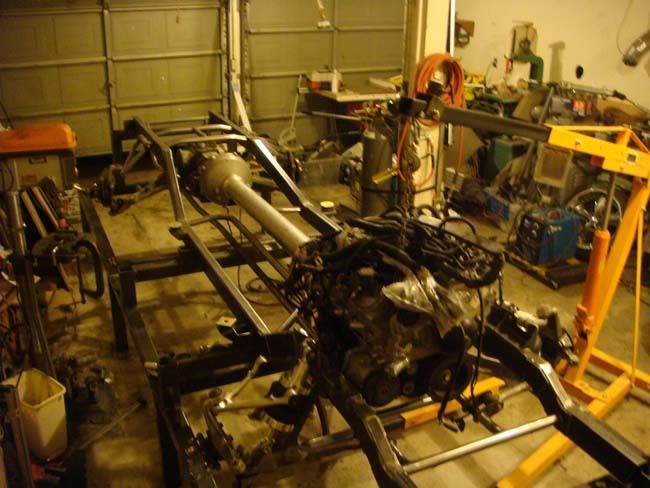

Here are a few pics during my build.

Wow that thing should be cool.
Rodger

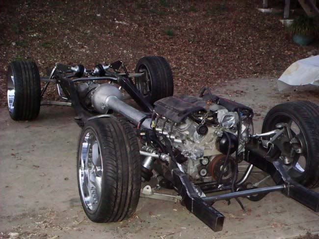

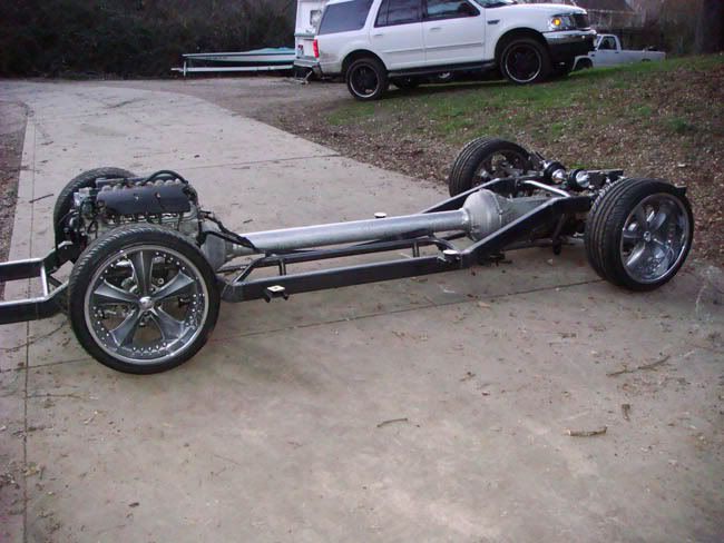

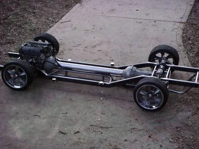

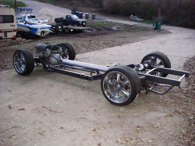

This is where i am now. This week i plan on starting the stainless steel gas tank then work my way into the motor and the turbos

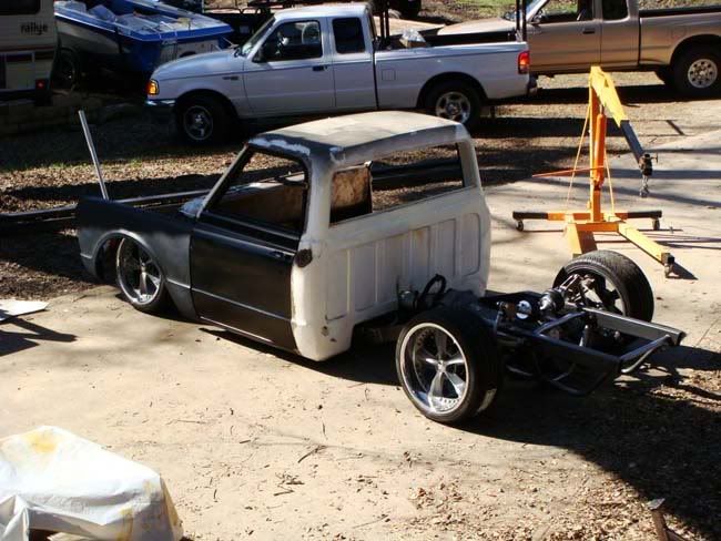

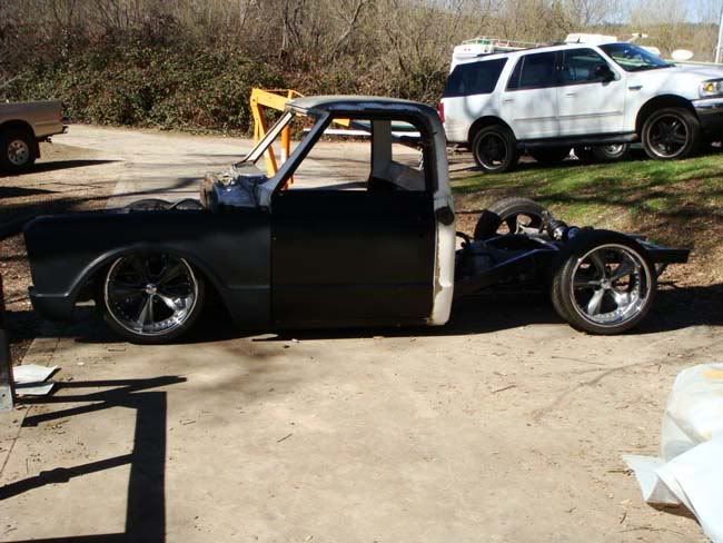

Here are two pics with some sheetmetal on. The sun was pretty bright so the pics aren't the best. Anyways enjoy

syborg tt's Avatar
Posts: 8,441
Thanks: 5,631
Thanked 2,032 Times in 1,093 Posts
That chassis is so simple and OEM looking - Man that's some great work
