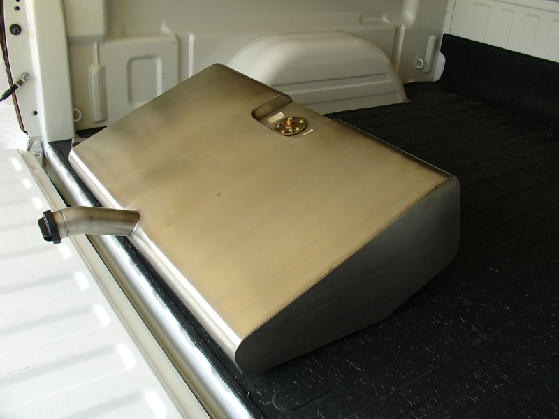

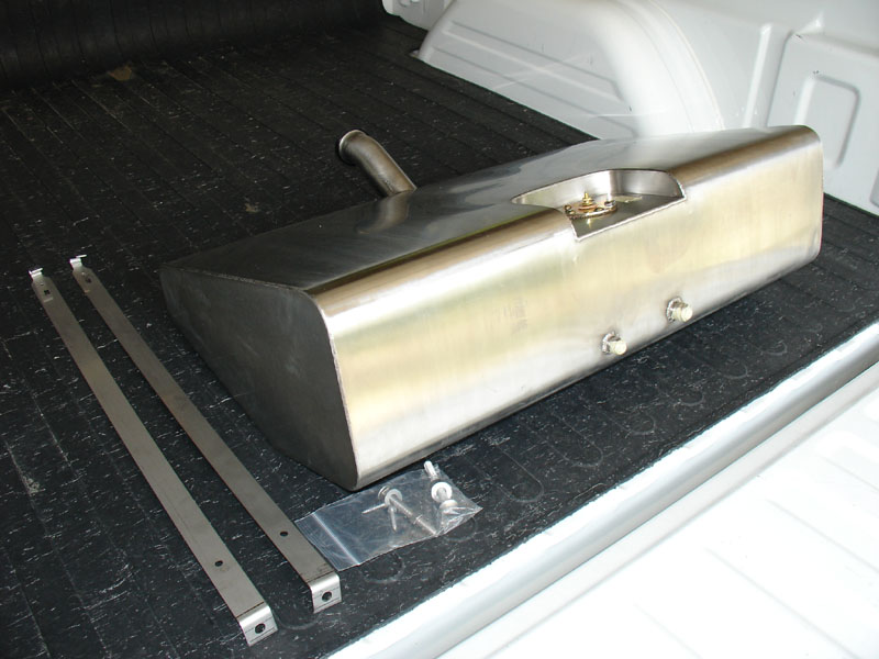

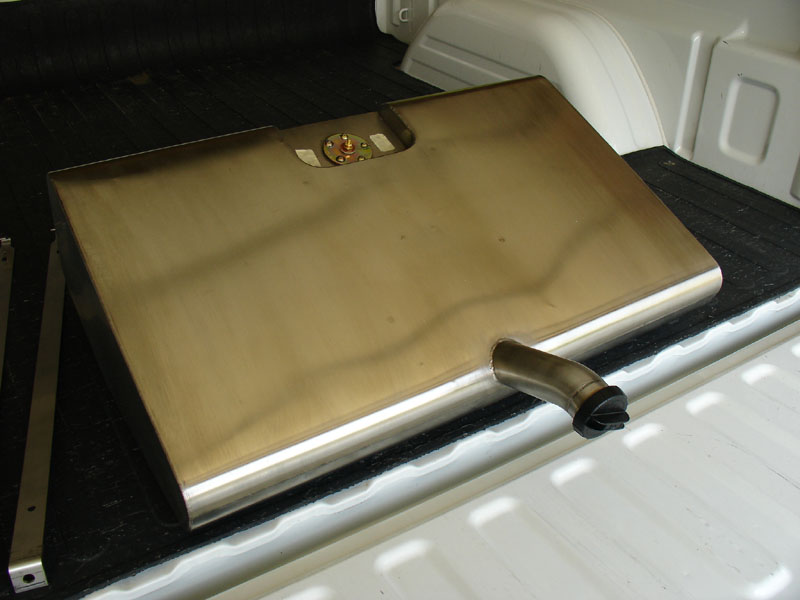

Default Rick's Hot Rod Shop stainless tank
The stainless tank that I ordered from Rick's Hot Rod Shop arrived today. It's narrowed for the mini-tubs, has integrated sump and baffling for EFI, has a -10 pick up and -8 return, a GM 90 ohm sending unit, and is slightly deeper to make up for being narrowed. It should be right at 16 gallons.
It looks fantastic, the craftsmanship is first rate. Thanks again to all the guys at Rick's.

I like it!

stupid question.... where is the vent? vented cap only?

Vents suck.. run a vented cap..
Well at least mine did.. nothing but trouble till I capped it off and swapped the cap.

Looks awesome...sucks that it has to get put under the car...sometimes you want to display even the gas tanks!!

There are threaded bunges on either side of the sending unit that are for hooking as a vent.

Just a quick NOTE about our vents... Unlike other tanks with vents our vent provisions are different. The bung extends down aobut 2.5" into the tank they will accept a roll over check valve, and have a piece of 5/16 tube welded to it that goes to the highest part of the tank. This in effect greatly minimises the amount of fuel that can possibly exit and also cuts down on fumes.

i saw the tape next to the sender.... wasnt sure if they were vents or not, since they would greatly lower the fuel level...but the bent tubes/check valves make sence.... i get it now. thanks

It's a work of art. Very nice. Is that the OE 69 filler location? It looks high--like a 67/68.
