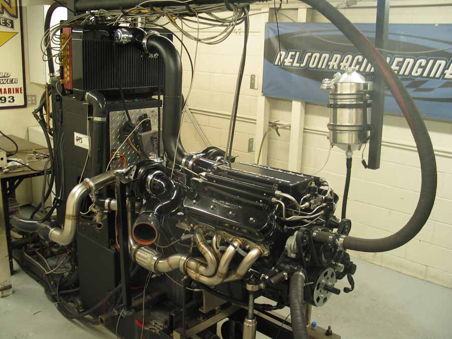

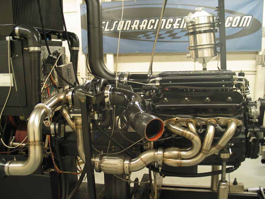

It's been awhile since i posted i fiqured i would chime in and show you guys the motor thats on the dyno right now.427 cube warhawk with twin turbo twin injectors per cyl.The dyno set up was really a pain but we are running everything including the mufflers.Heres some shots and a base 7 pound pull basically i fige it will make around 830hp at 7psi pretty insane.keep in mind this will make 39 psi we will lean on it this week all keep you up to date on it.

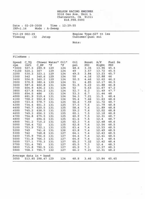

Default Dyno Graph
Dyno Sheet

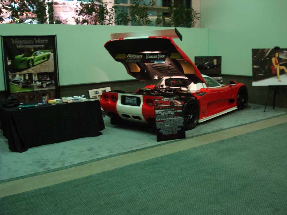

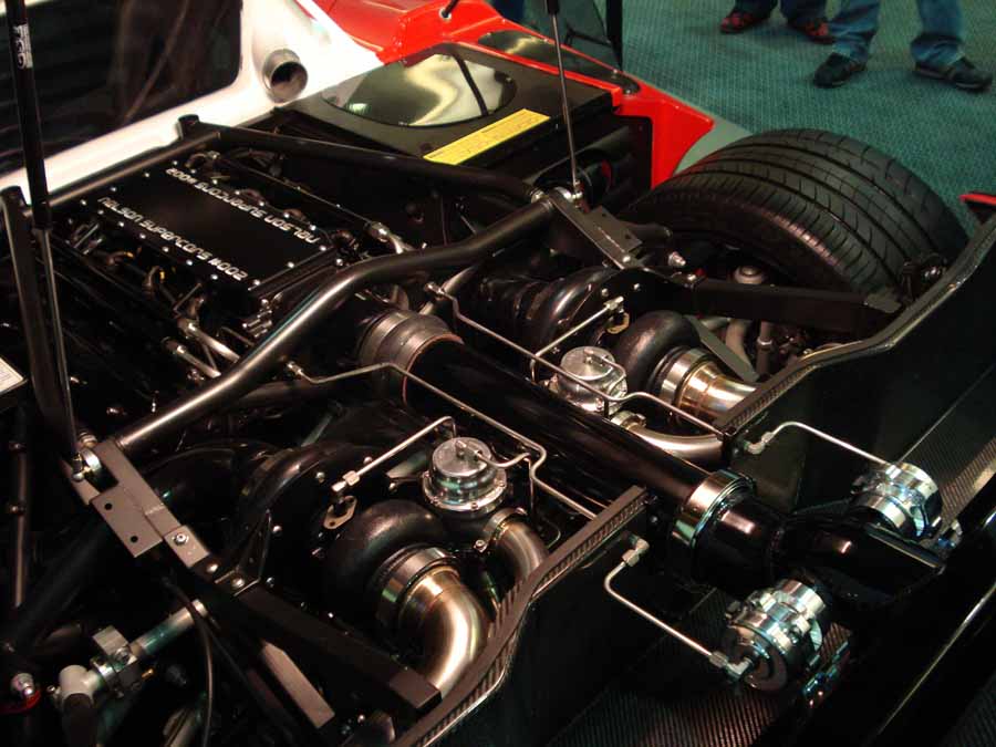

heres some shots of it mocked up,and the car
