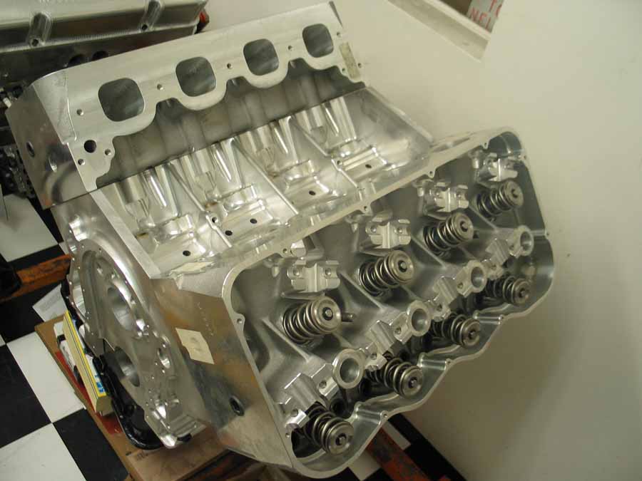

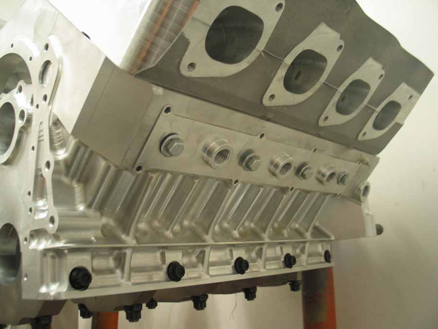

Like i said weve been rediculous busy so i havent had time to post that much so heres another one of my creations.I wasn't happy with what was availabe for the sonny leonard head bbc hemi head as far as block were concerned so we created a full water 100% billet block check out the 65mm cam tunnel 1.026 top fuel lifter holes keyed ,cross bolt main.Going in a promod with two 106mm hair dryers three injectors per cyl.And will be drivable on the street for whatever thats worth but still cool.We hope to break in the 5 second range with this motor.Tom Nelson www.nelsonracingengines.com
