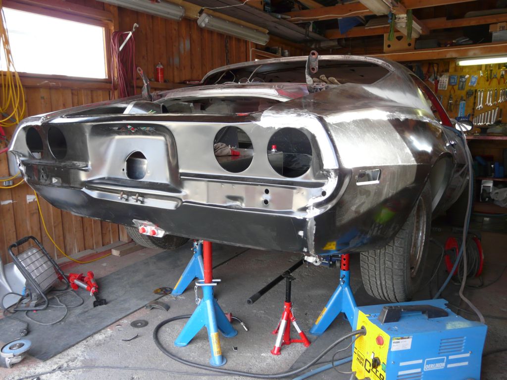

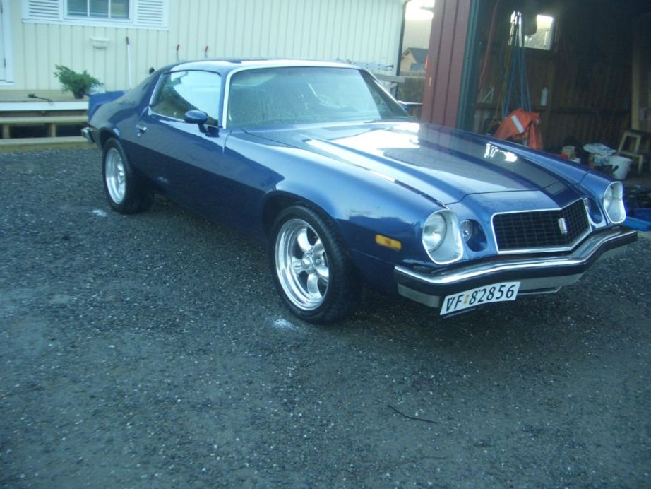

Well I lurking here for a long time now and its time to show you my project.
This project is the result of several things, I wanted a car i could I could use to dragrace, track days, cruise with the familly etc. but first of all a drivers car I could have a lot of fun with.

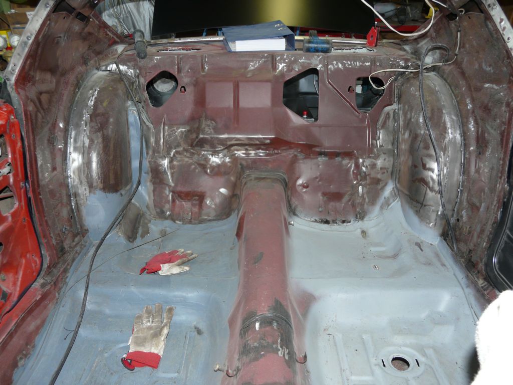

I started with a 74 that I change the body to a 73 the reason, I got the 74 cheap. The car had also a bit more rust than I expected so the has been a lot of body work and still not finished

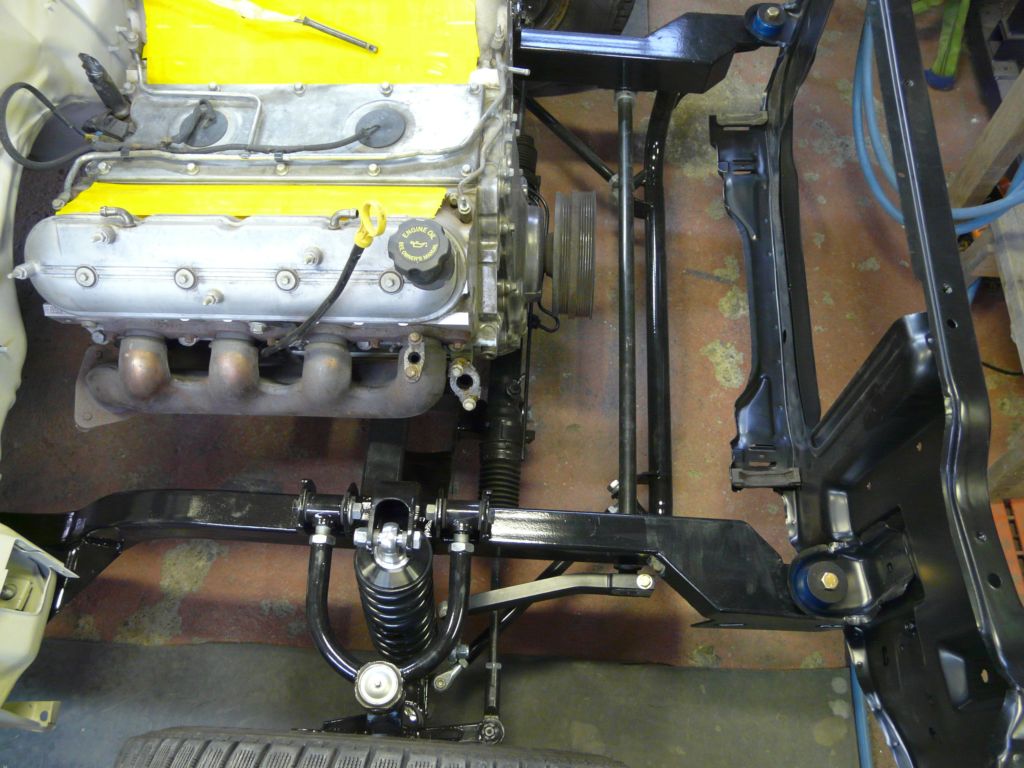

- Ls1 with Aps twin turbo kit for modern f-body, goal 800hp
- Martz 4-Link

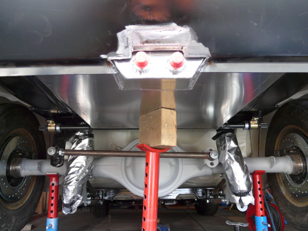

- Martz road and rally subframe ( exellent company to shop from great people )
- Ford 9" with 35 spline gundrilled axles
