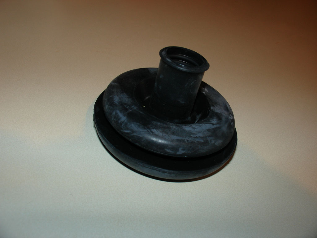

Originally Posted by Steve1968LS2 View Post
John at Speartech rocks.. I just bought three of their super killer grommets to have in the shop since they work so well (and I needed one of them for my AODe Fairlane install)
Steve,
Is the grommet for the harness. Got a pic?
Thanks,
Tom

Originally Posted by tom_a View Post
Steve,
Thanks,
Yea, it's the grommet they send out with thier harnesses, for a two inch hole. It's extremely hard to find nice gromets this big and they are great for passing large looms through metal. The fairlane had a large loom that needed to go through the floor for the new transmission and this worked perfect.
I will dig up a picture.
Thanks,
I just went out and looked in my box as I got my harness and pedal assy from him. I guess mine did not come with one.
Here you go, Tom:
My LS7 69 Camaro
