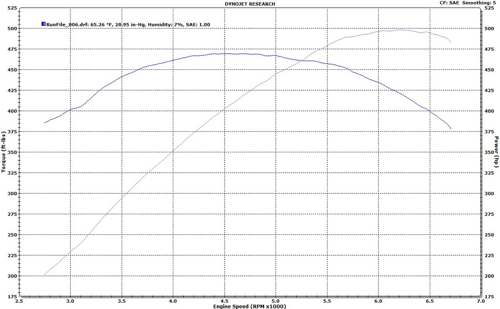

SAE: 498rwhp and 470rwtq

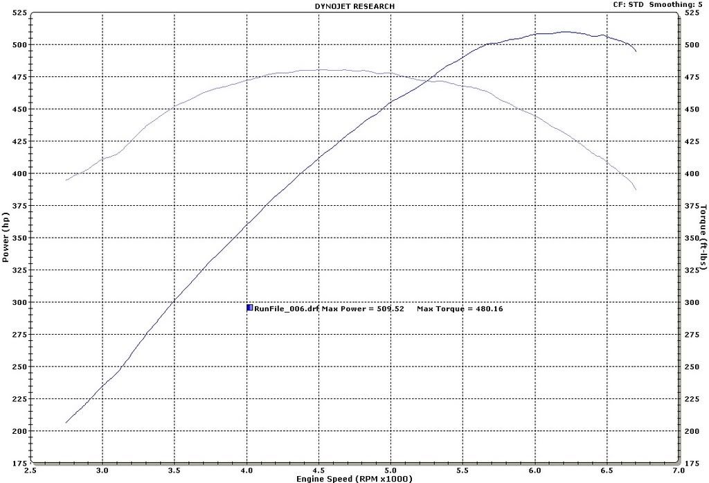

STD: 509rwhp and 480rwtq
I took the day off and took the car to HiTechMotorsport and had it tuned on a chassis dyno. The baseline pull with the stock LS7 tune put down SAE 468rwhp and 436rwtq. After some tuning, it made SAE 498rwhp and 470rwtq... and that's with no cool down. Casey and I took it out for a drive after the tune and it's amazing. It pulls hard from the bottom and never stops pulling (until I hit the 7100 rev limiter). Not bad for a baby cam: 220 / 244 @ .050, .615 / .648 lift, 110 LSA.

have them do a printout converted to std instead of sae; you'll be over 500 rwhp, and many guys use the std numbers.
Great job, gotta be a blast!!!!!!!!!!!
I can help with that.. Here ya go
