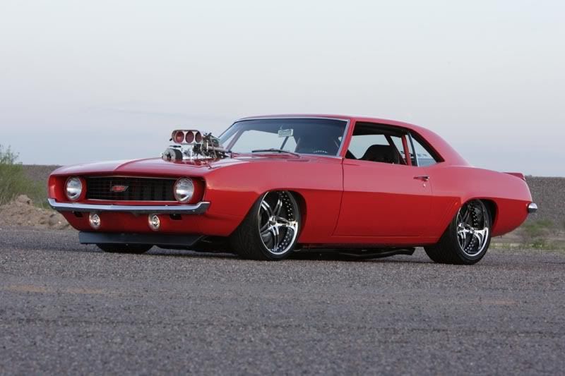

This would be the look I am going for (not my car 'shopped):
I am kind of going for that sleeper look and really just want to run the rallyes, I have looked at so many wheels that will fit the C5 brakes, but I still just want/love those rallyes
