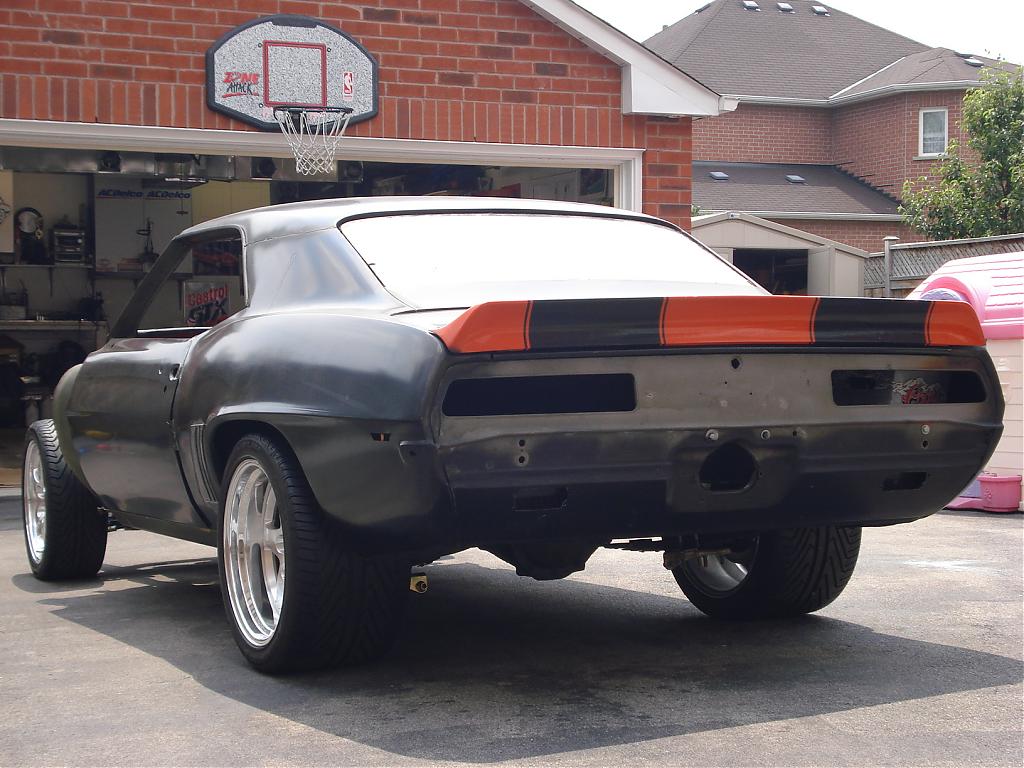

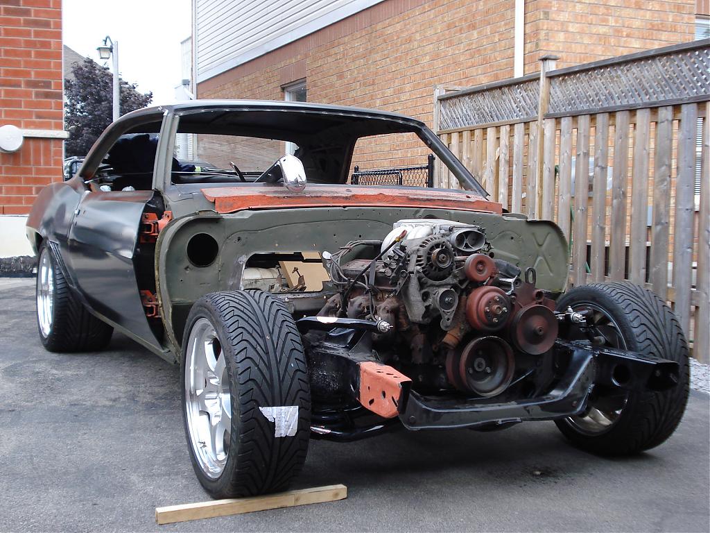

Hey Mike I think I know what you are looking for.I have a 335 30 18 on a 18x12" rim and it sits flush on the rim.I will attach a pic and also some new pics with the control arms and thanks again!!

Yep, I have same size. Pretty common combo on rears that are mini-tubbed.
