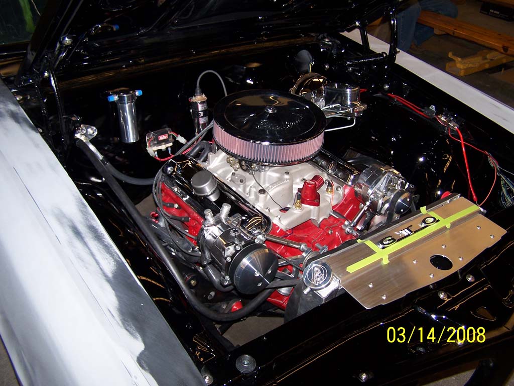

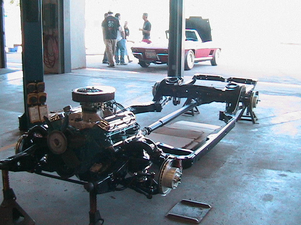

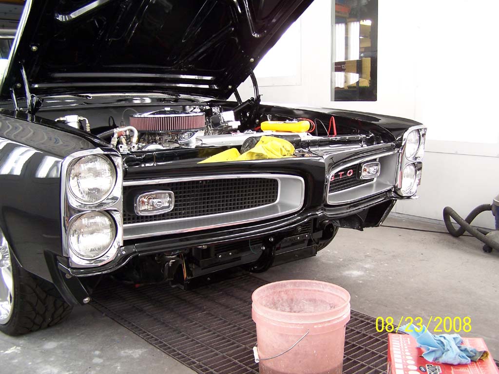

Hey guys, I am a 24 year old car builder/ CNC operator from Galesburg, IL. When i was going to Carl Sandburg College, i was fourtunate enough to help my then shop teacher with a project that he had taken on on the side. That was December of 2004. Finally, almost four years and a lot of changed minds later, using only the time my teacher and i had in between classes and our other jobs, the car has just finished being painted and is almost completly assembled. Here are a few photos from along the way. please let me know what you guys think. Keep in mind this is the first car i have completely built. I will post more photos when the interior and assembly are done. thanks.

Ok here are some specs and a few more pictures to tide you over.
.030 389
eldebrock dual plane intake
edelbrock 650 carb
modified ceramic hooker headers
custom remote oil filter system for header cleanrance
be cool radioator w/dual electric fans
march serpentine conversion kit
Trans
rebuilt factory muncie t-21
Rearend
Factory BOP 10 bolt
auburn limited slip diff
moly moser axles
T/A perfomance girdle housing cover
Suspension and steering
Front
QA1 coilover conversion
hotchkis tie rod links
all urethane bushings
Rear
Metco Motorsports Billet adjustable control arms
custom coilover brackets
QA1 coilovers
front
SSBC force 10 two piston calipers
12" rotors
Rear
SSBC force 10 single piston calipers
11.75" rotors
Body
shaved all lower moldings
shaved tailpan/trunk molding
filled all body seams
molded hood scoop insert
moved fuel filler to behind the rear window for the cell in the trunk
color - House of Kolors, Jet Set Black
Interior
custom door panels
custom seats
all red ultimate leather
custom dash w/ Autometer Ultralite II's
full vintage air a/c system
dynamat extreme heat/sound absorber
Full 1000 watt Kenwood stereo system w/ satelite radio
Ok, that is about it. hopefully that will tide you guys over for now. thanks for all of you input

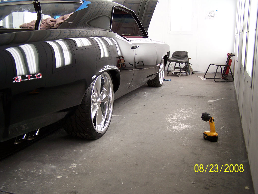

sorry, i forgot the wheels.
they are Foose Nitrous II's with BFG KDW's
front - 18x9 w/ 225/35 r 18
rear - 20x10 w/ 265/30 r 20
that should be everything.
