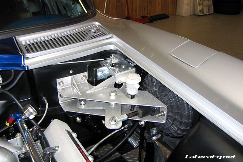

Hmmmm... the brake booster was relocated 90 degrees to a spot under the fender. It may be that the linkage geometry isn't quite right which may be causing the problem you describe.

Here's what Mark is talking about in case someone doesn't know how it's laid out:

Woody called it... Ends up there wasn't any freeplay in the rod that goes into the master cylinder. I added a couple shims (washers) between the booster and MC and the problem went away.
