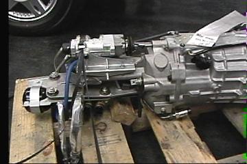

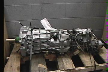

You mean this?

The one pictured is a paddle shifted T56. Gearbox is Aston Martin, paddle shift stuff from Ferrari.
