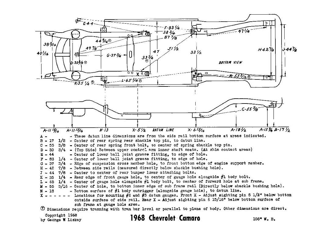

I would say that you need to measure both the body and frame... and see where the discrepancy is first.
Was the differential centered before you did the bushings ?? Do you know if the car has ever been in an accident ??
Looking for the "easy way" doesn't necessarily mean the "correct way" to solve your issue. I would not recommend moving the spring perches... nor would I ever recommend using a different offset for a single wheel... those are just band-aid fixes that do not solve your issue.

I think like Chicane said you gotta figure out what is off about the car first, before you take any corrective action, otherwise the "fix" might cause other problems.
It doesn't take that long to run a couple plum lines and measure a few suspension points to get a pretty clear picture of what is off. I had a similar problem with the rear end in my car being offset to one side about 1/2". I was able to figure out it is more of a body issue than a suspension frame issue by running a few lines and measuring.
