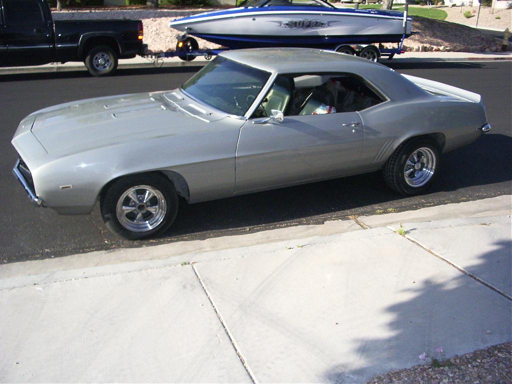

I have been stalking the forum's for quite a while and finally decided to get on board. For nearly 6 months I have been tearing down my 69 Camero and just got it on the rotisserie tonight. The current plan it to roll the widest tires that I can with out tubbing, with quality brakes,steering and suspension. Already have an LS1 that am planning on carburating with a hot cam and lots of head work. Have not decided on the brakes and suspension among many other items. Any input would be appreciated.
