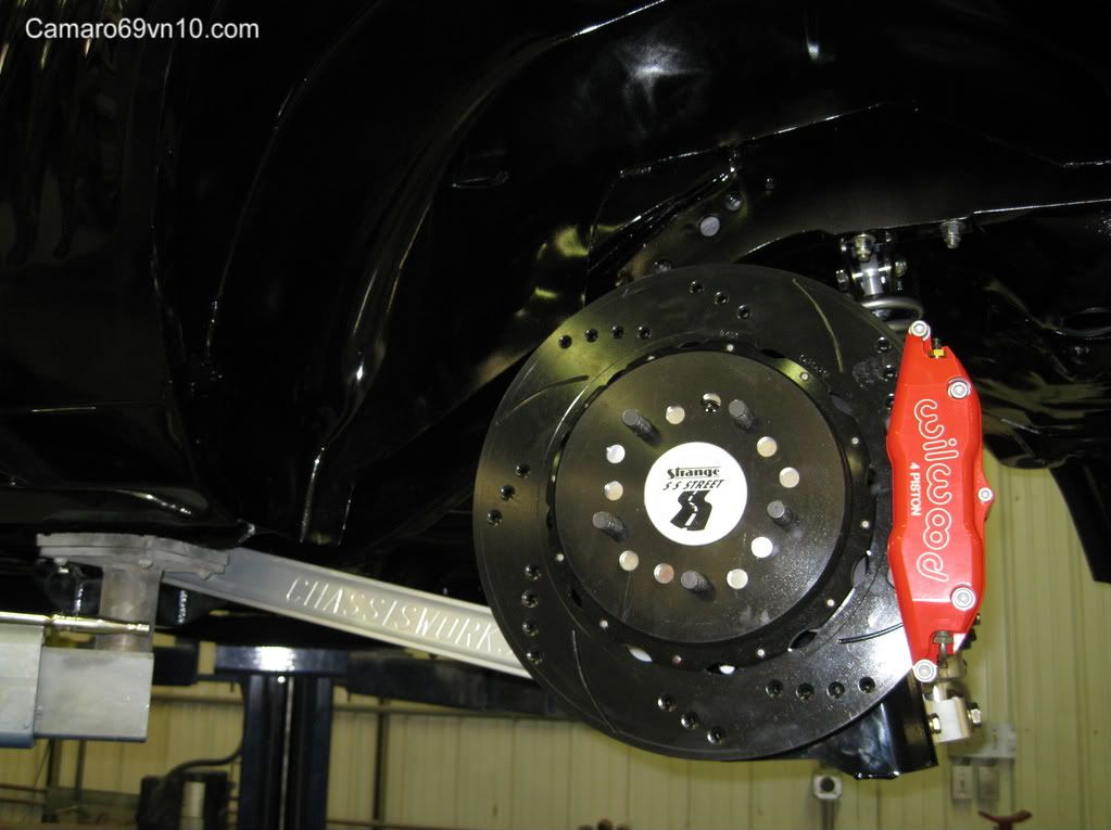

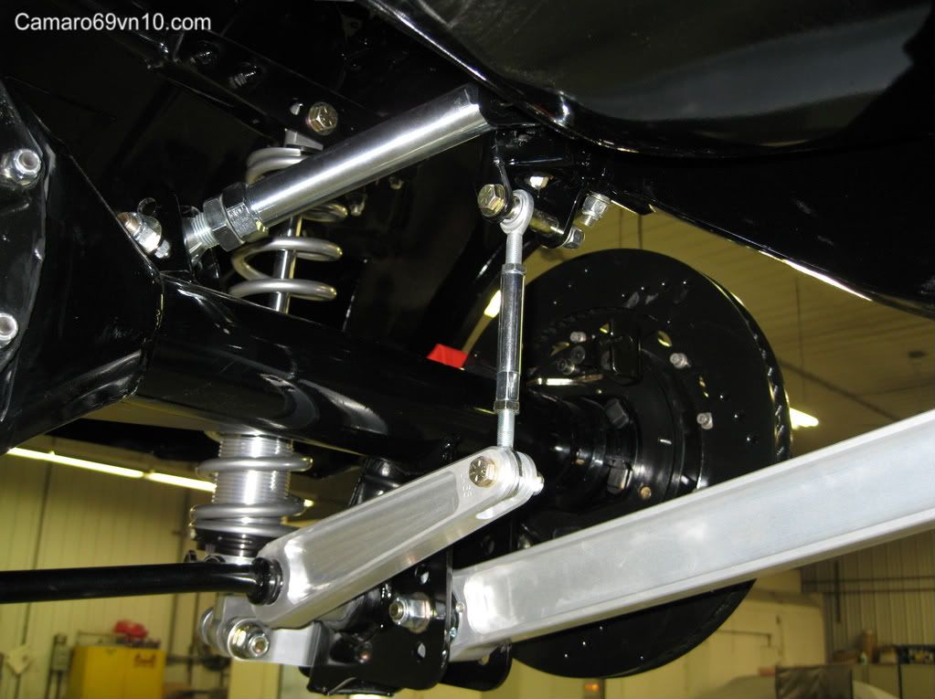

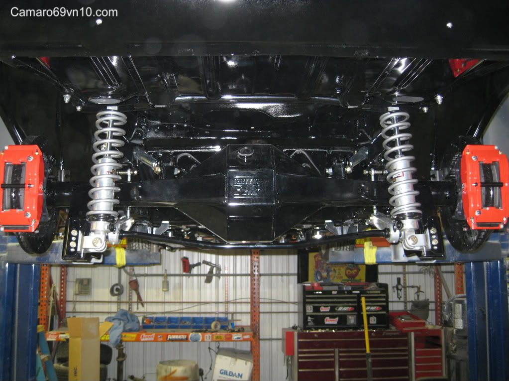

Default The new Chassisworks g-link installed in 69 Camaro!
I received the new Chassisworks g-link about 2 weeks ago and the guys at the shop just finished the modifications and install yesterday. The guys did a great job and it looks great! See the previous post from Frank on the modifications needed for a mini tub. I will post better pictures and more info early next week.
