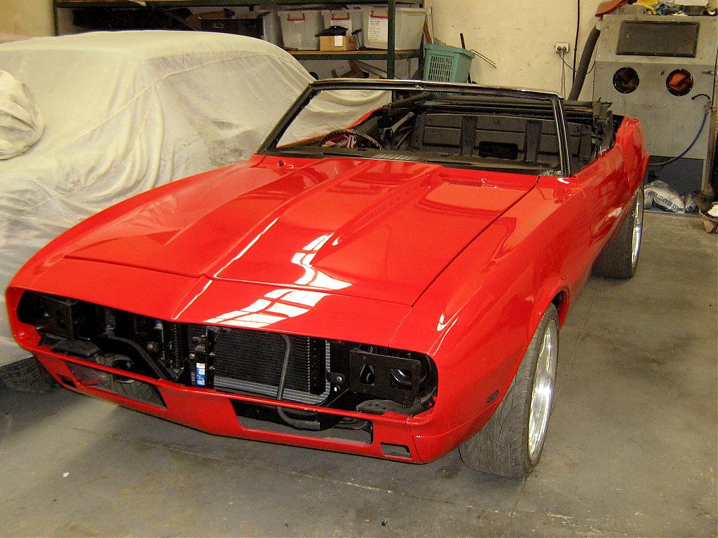

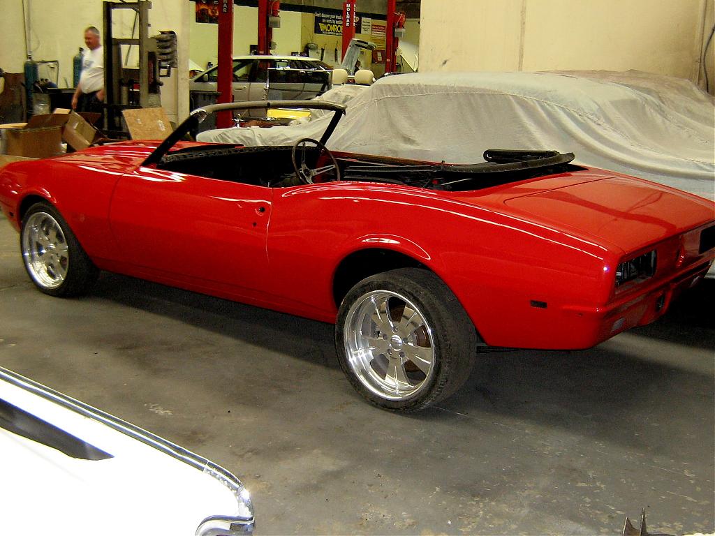

Smile Update
Boy those 9 months went quick. Well we started it up today, fired up straight away and it settled in to idle perfectly. Very happy about that, since I purchased engine & gearbox way back in 2001. Just some recent pics, now to get bumble bee & black tailpan painted, then finish assembly. Waiting on bumper bars to come back from chroming. Seats at trimmer already and has material now. Should go over to trimmers in a couple of weeks to fit interior and roof. Not much longer now, .
Roger
68 RS Camaro Convertible LS1 6 speed
72 C10 SWB Stepside, old skool 350 4L60e
71 K5 Blazer 350sbc T350

Talking Update, at the trimmers
Well car arrived at motor trimmers today. They want it for about 3 weeks. Really getting close now. Some pics from this morning.
Roger
