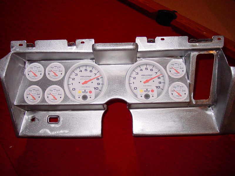

Since I'm having to mix gauges I am photo shopping my cluster and then I will use it as a template so those measurements will help greatly.

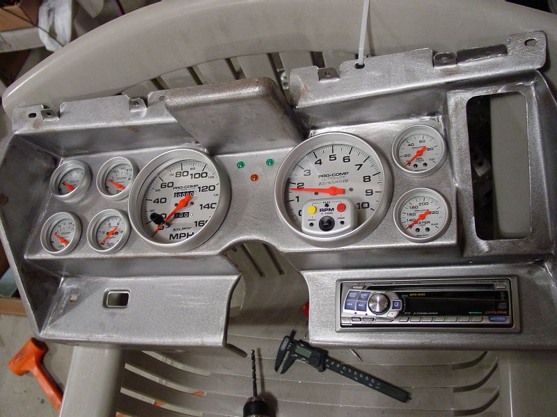

Here is what I have planned.
Pro Comp Tack and Speedo. 3 3/8
Sport Comp water, oil, volt, fuel and boost/vacuum. 2 /1 16
Wanted to stay with the Pro Comp gauges but the 2 5/8 gauges are to big to fit all of them into the cluster.
The Innovate Wide Band will have a silver bezel so it will blend in better.
What do you think?

Looks good, Photoshop has so many uses.
