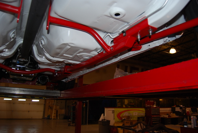

Heidts#14 Heidts#14 is offline
Join Date: Jan 2009
Posts: 48
hold that thought Randy...........
Getting pics up asap
Old 02-06-2009, 11:01 AM
Join Date: Jan 2009
Posts: 48
Lets try this one

Thanks for posting the pic of the subframe connector install. Seeing it gave me another question though. The mounting bolts at the rear of the connector that go up into the rear frame rail, are they going through existing holes in the rear rail section or drilled through the rail and up into the floor ? Oh and do you have some side profile shots with the car on the hoist ?
Thanks for any help with this.
