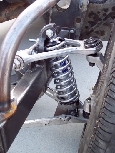

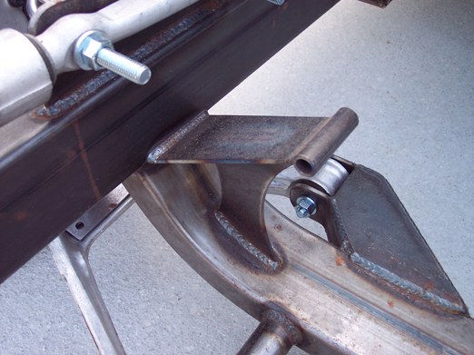

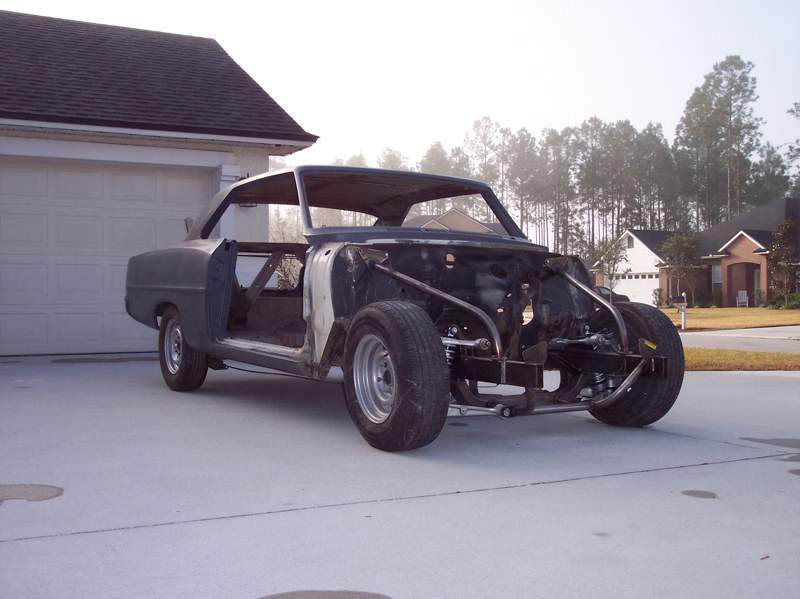

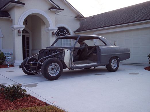

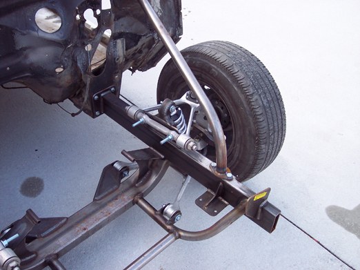

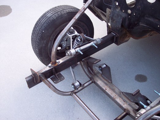

OK - here they are. Keep in mind I just threw everything together with the original ball joints etc and bolts I had layign around the garage.... I working on mocking up the C4 rear so I can get a better idea of the ride height. I'll post more pics when I have them.
Ryan
Pics will be in a couple different posts

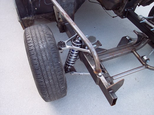

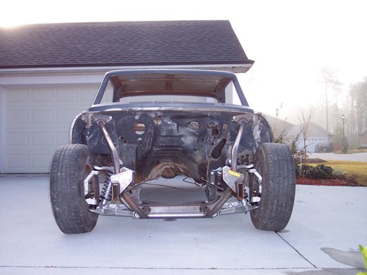

Some more....
