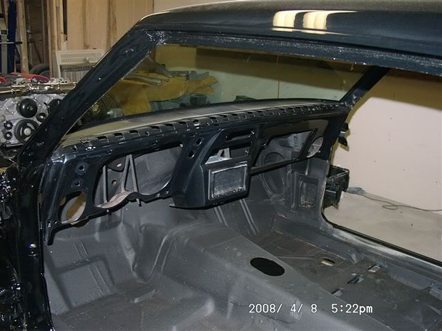

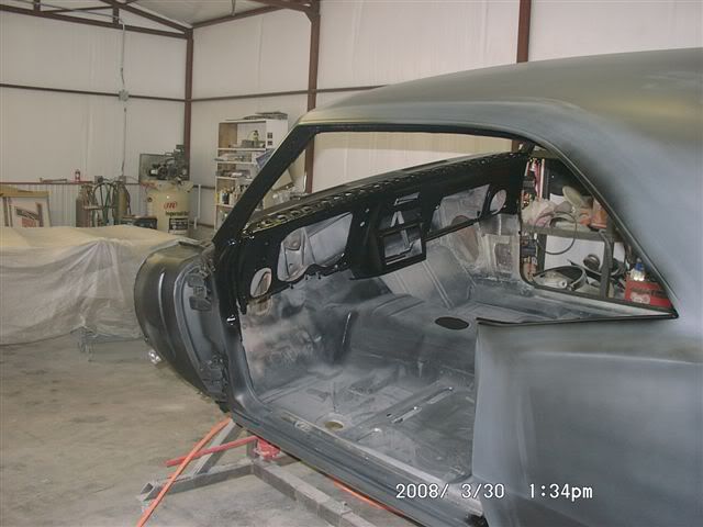

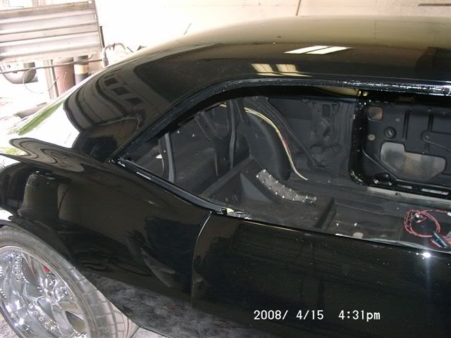

No trimming necessary. The trim isnt as tall as the weatherstrip or the flange that is on the interior side of the top (Where the pinch moulding goes that covers the Headliners attachment....Just paint them black, they fit right under. Like this.
The flange seen in the pic is the flange that accept the pinch mouling... it is actually hidden by weatherstrip...

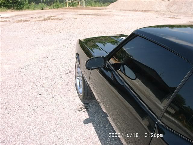

I cant seem to find the pics of the actual cutting.. But what you see here is after they are cut off.. The rise just at the edge of the top is the factory shape of the top. I accented the factory rises by cutting a slight V-Channel at the edge of this rise. It just highlights it a bit from the side profile. We tried the totally smooth look, but from the side profile, it appeared to be lacking something.
If you have any questions feel free to PM me or give me a call.. I can talk you through the process...
