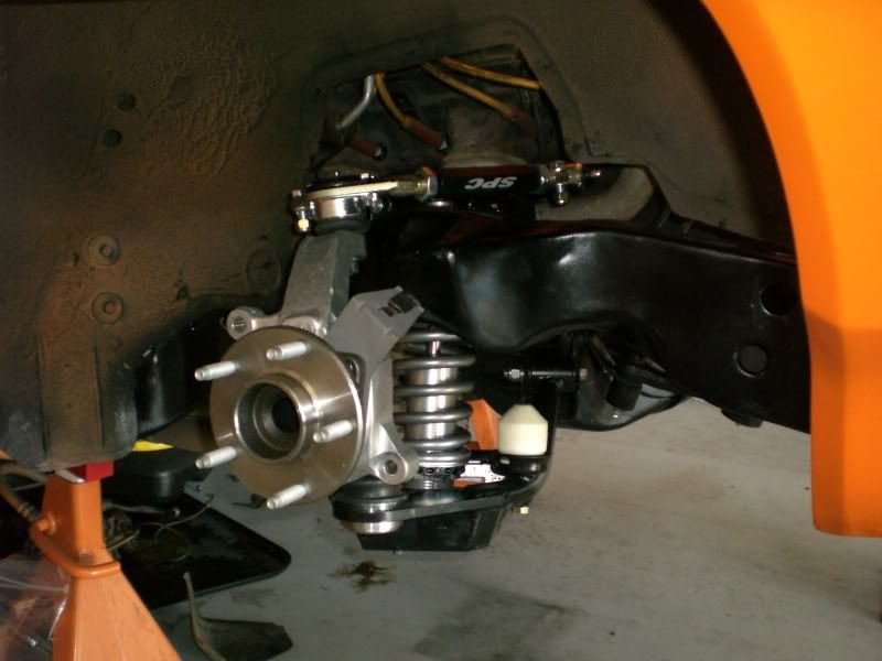

I have a 68 GTO as well:
SC&C front and rear suspension setup. Really handles nice.
In progress pic:
Give Marc at SC&C a call he is always willing to help. So is Frank at Prodigy Customs. Great customer service from both.
