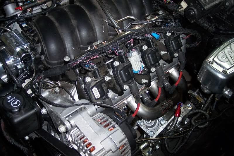

This was taken at the begining stages of my build. I'm running an ATS box and the Autokraft/ATS mounts, with Stainless works headers. I had to massage two tubes..It was super easy with the headers since they came in raw form. I just did some heating bending then just polished it right up..
Kind of hard to see in this pic but it might help some..Good luck
