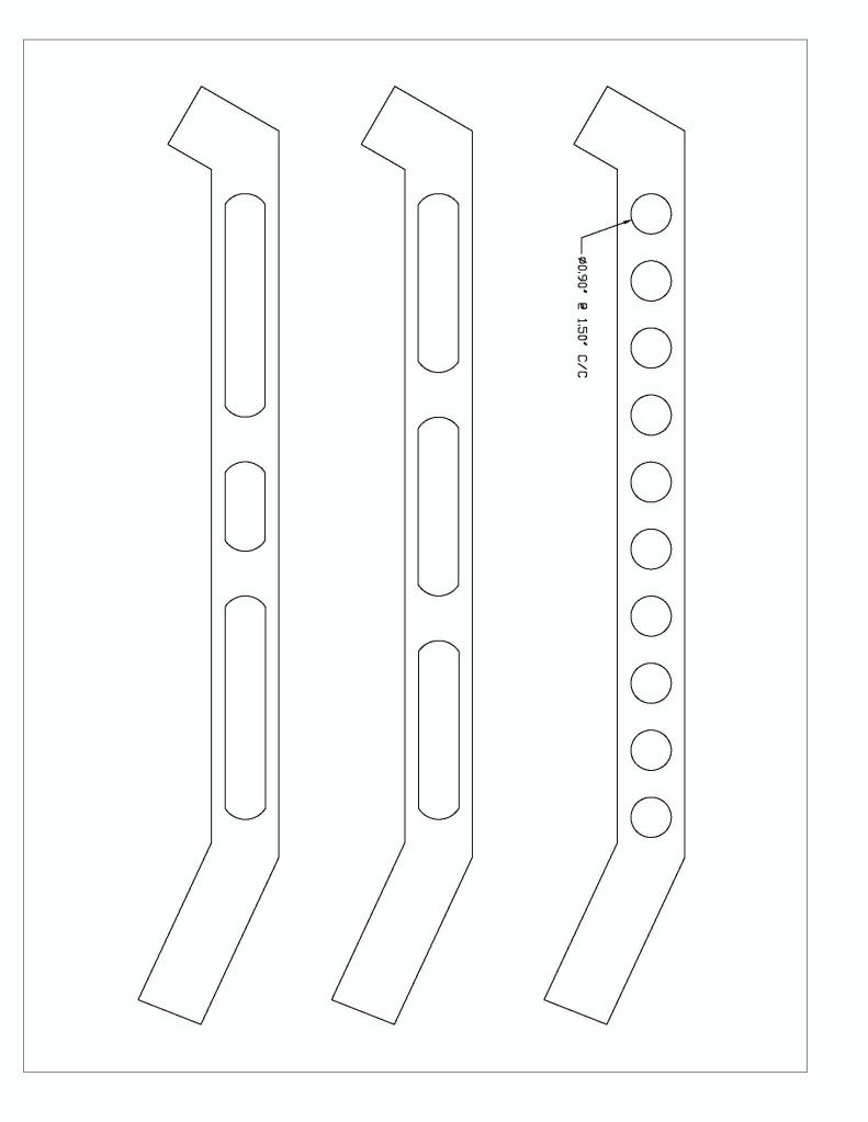

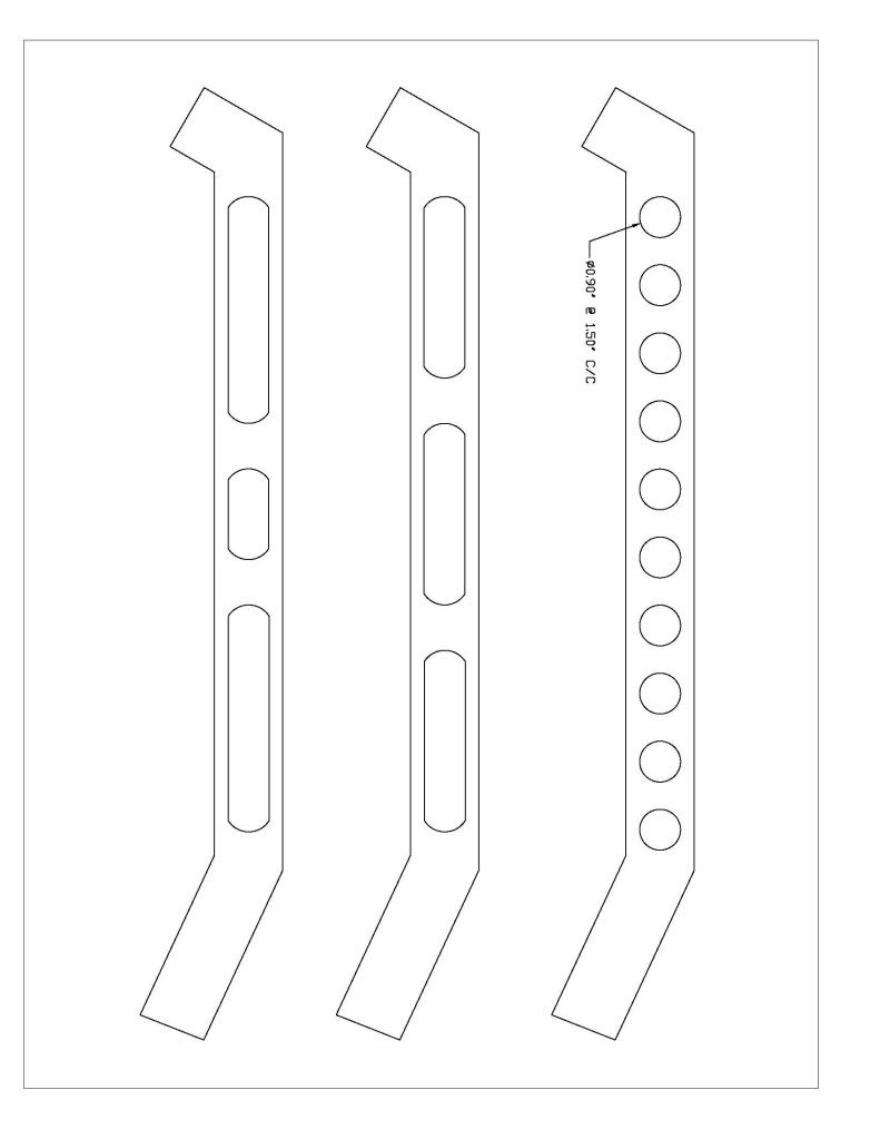

i bought stock the other day, 1/4" 6061 aluminum, cadded a template of my 3 choices, and... well take a look..

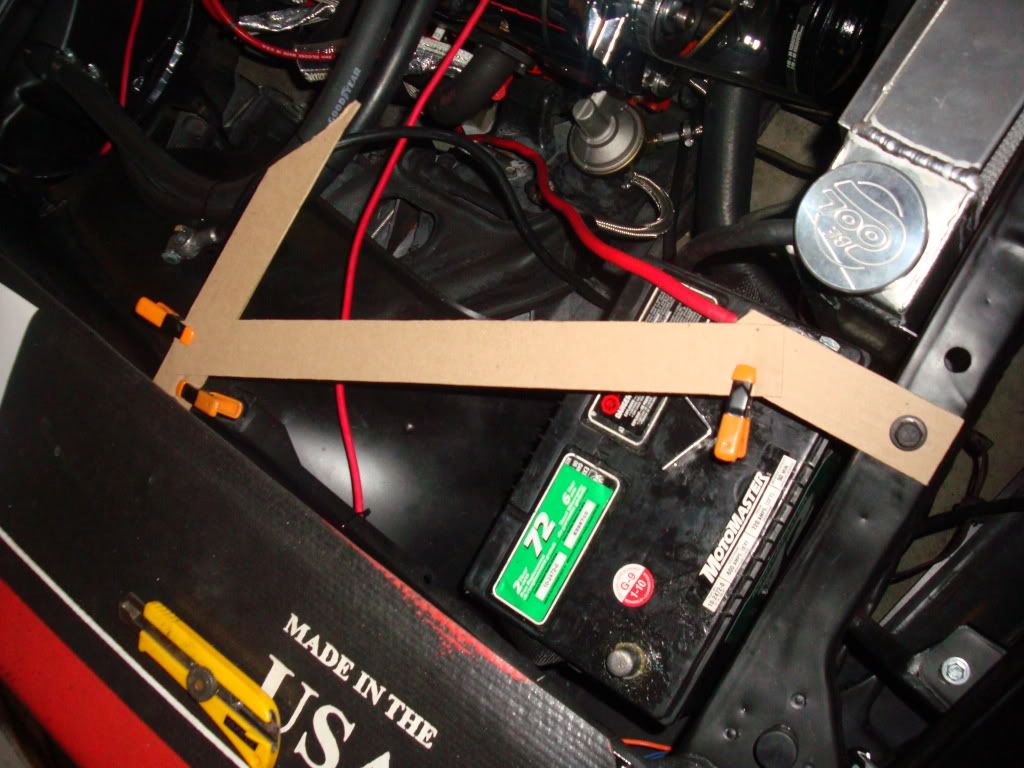

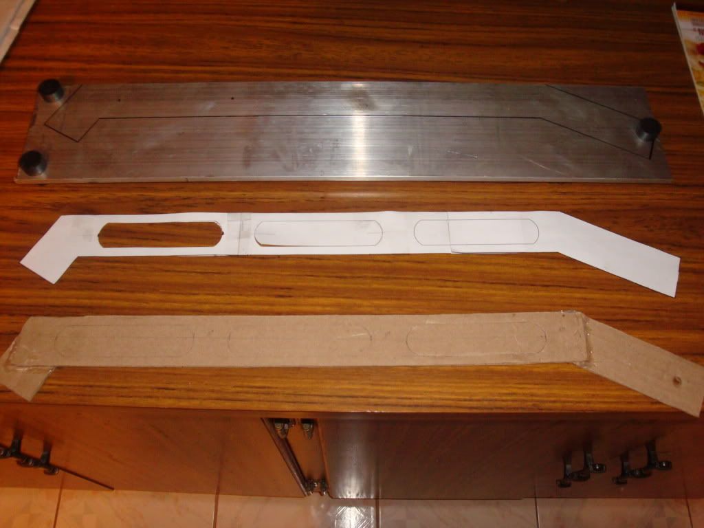

I laid card out 1.75 wide, and made a template to get exact angles i need, and also easier to see what it would look like playing with each angle.
then, cadded up some templates based on my specs, made a few designs and picked which one i liked best..

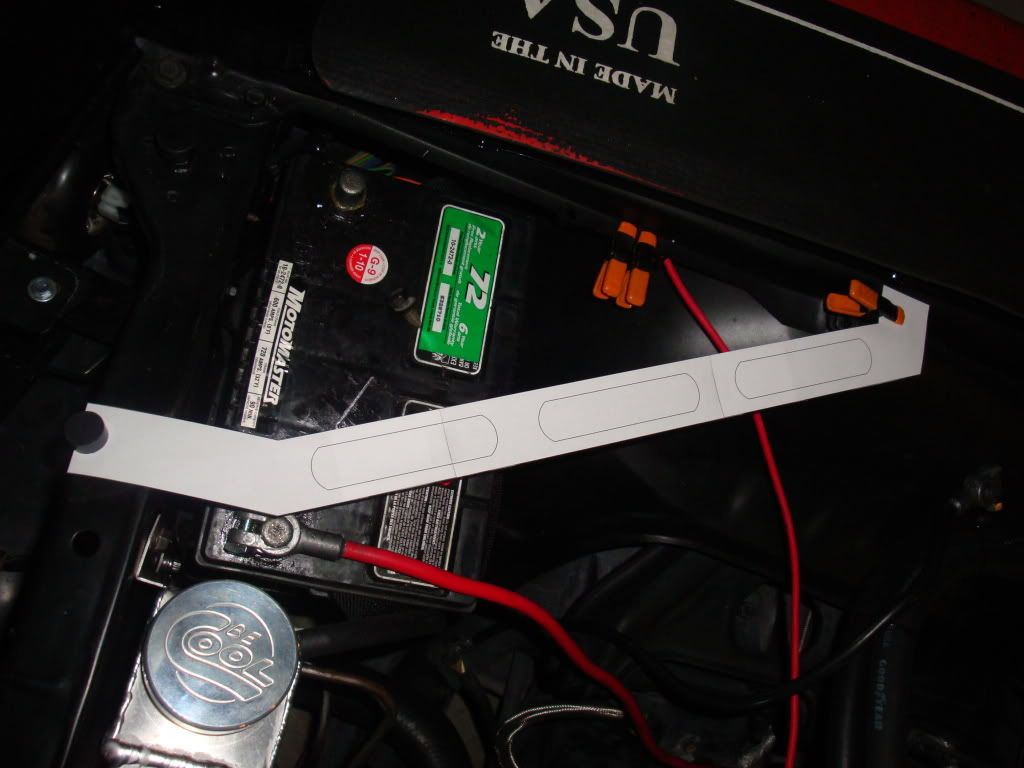

made template to size, printed it and mocked it up
transferred the paper to the stock

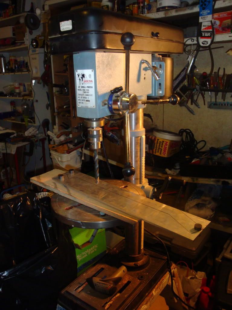

my new toy for 90$ lol

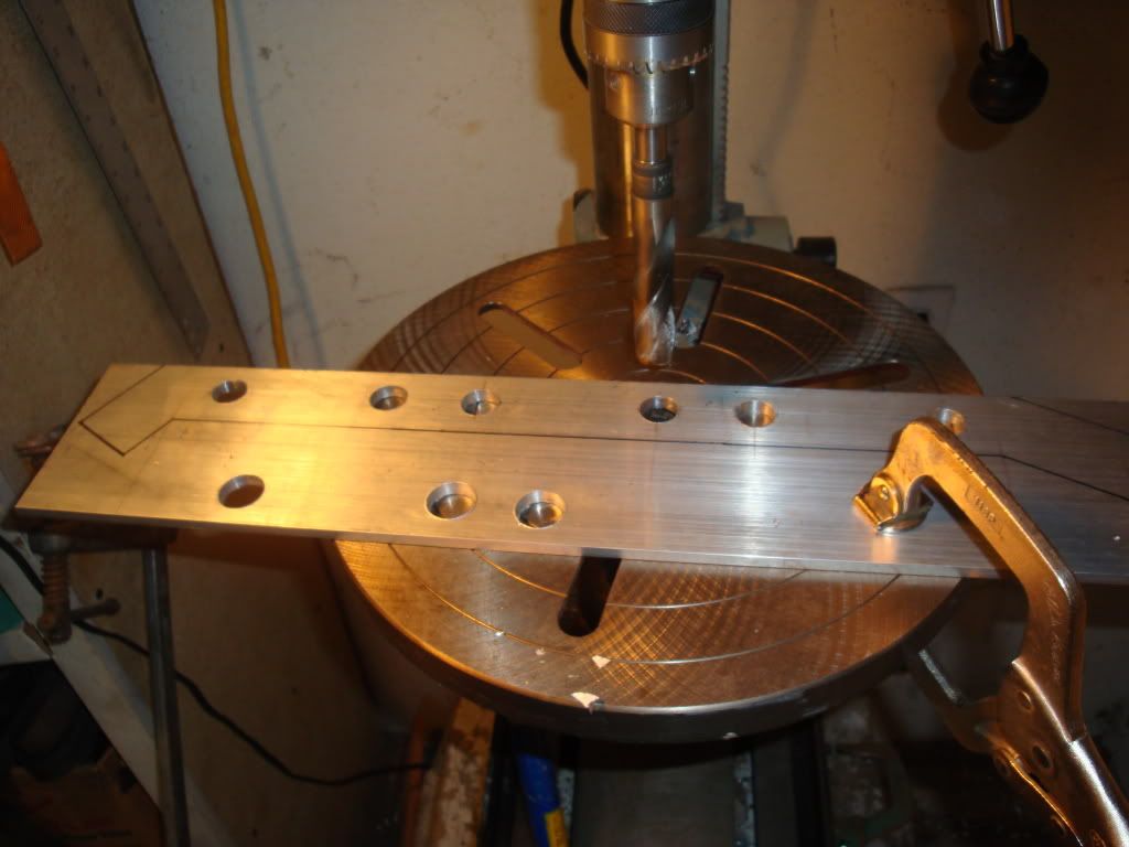

drilled my holes

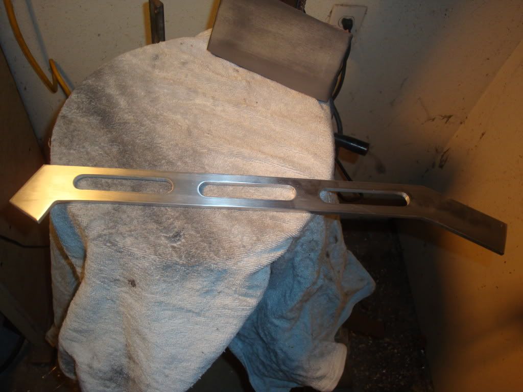

cut and sanded to brushed steel, started with 260-400-600 grits, matches my radiator

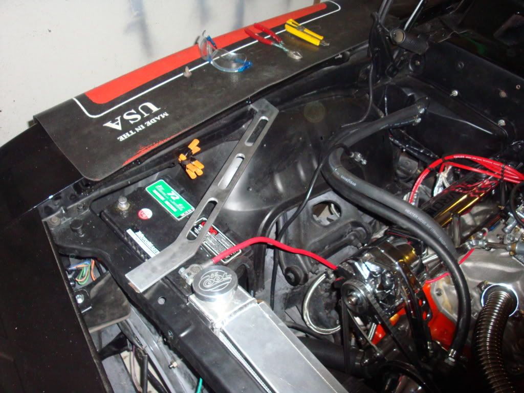

right before mounting
dont mind my engine bay, super dusty!

Good Work!!! Do You Think It Will Have Enough Material Left To Actually Do Some "bracing"?
Old 10-06-2009, 09:57 PM
MaxHarvard's Avatar
Location: Hugo, Minnesota
Posts: 2,001
Looks good so far! How are you going to finish it on the fender itself?
Old 10-06-2009, 10:31 PM
camaro1969 camaro1969 is offline
Join Date: Apr 2009
Posts: 157
i have brackets that will mount on the existing fender and screw in the original brace holes
Vic
Old 10-07-2009, 12:17 AM
Location: Finland
Posts: 1,919
Thats the way to do it
