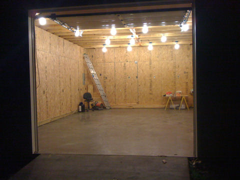

Has anyone seen these 300w cfl's? Found them at Lowes. They work great and only use energy of 65w bulb. I used 13 of them in my new 20x30 shop. Cost me $190 and have a bulb life of 6000 hours. Just wondering what everyone else is using?

Looks pretty bright. I'm not really up to speed on CFL options, do you have a choice in range on kelvin?

These are the only CFL's I could find at this wattage. There are no others (at least that I could find). I prefer a bulb around 3800 Kelvin. I think these are around 2700 to 3000. Slightly more yellow than I would like but still work great for the price.
