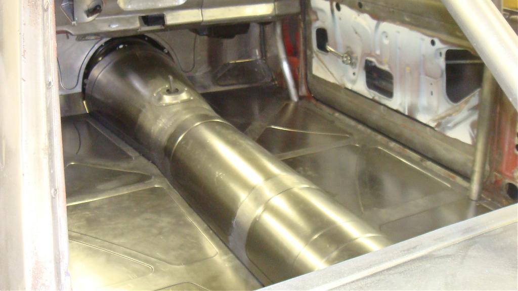

Hey guys just wondering what different techniques/methods/machines people are using to stamp floor pans, wheel tubs etc. Some peoples work looks awesome. (I stole a couple of pics, hope you dont mind!!!)

You stole those from WAR --- and he said he's using a bead roller....

yep, looks like bead roller

Not sure if it was WAR or another one ( might have been one of the Austrailian builds going) but they used a wood form and hammered the detail in around the edges. It was a top and bottom plate with the design shaped in them, metal between both plates and just tap away till it gets there.

First one is from Best Camaro in the Universe thread. Second is from War's 69 thread.
You can make them with a: Bead roller, stamp die, hammer form, or power hammer with flange die.

I think the first one is from the Runt Chevy II

Crap, that's what I meant... Thx !
