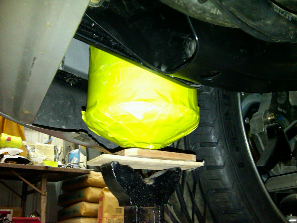

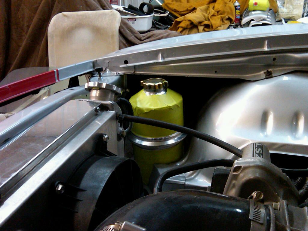

Looking for an opinion regarding the depth of the oil reservoir for my LS7 in a a 69 Camaro. Have a Peterson tank 19 1/2" tall x 6". Installing in front of right inner fender. Note in photos, it sits about 2 1/2" below the subframe. It looks like it sits too low. Probably won't see it with the chin spoiler on, but don't know if it's too exposed. On the top side, the cap is only 1/2" from the bottom edge of the fender. Don't know if I want to change tanks to one that would be about 3" shorter as I would loose some capacity. Especially now that GM has increased the capacity on these another 1/2 gallon.
The way I see it is I could get a shorter tank, and add an oil cooler that would hold the amount lost, or just let it "hang out" as is. Maybe the people that have done this swap could chime in as to how low yours is?

I know its a bit of work but I'd have someone weld the tank shut were the filler cap is now and then weld in a new filler neck were it doesnt interfere with the fender.
you would gain at least an inch, maybe more.

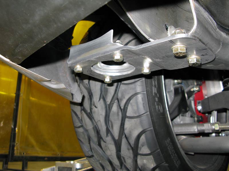

I've scoured this site and many others looking at pics of oil tanks, but not many show how low they hang. Have seen Scott's photo you're talking about and it appears to be about the same distance below the subframe rail. What has me baffled, no pun intended, is this pic from the good people at DSE. Note the bracket to hold the tank. It appears to set the bottom of the tank close to level of the subframe. I have been speaking with them regarding this, and they have graciously offered to measure the height of this tank (also peterson), but it is currently at the upholstry shop. Peterson has offered to exchange the tank if necessary. I just want to get it right before it's too late.

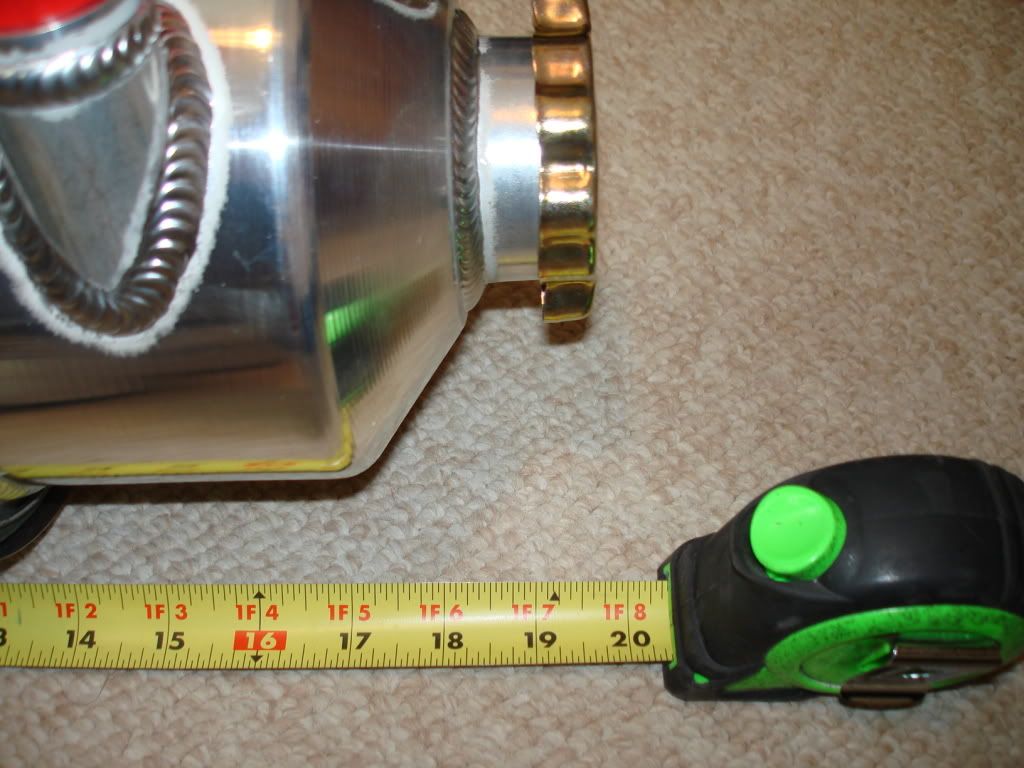

I measured mine just to see if its different than yours(2 gallon). Perhaps DSE is using a smaller peterson tank. please let us know what you find out from them.

Bill, I can't remember the exact height measurement on my tank, but it sure looks the same as yours. The bottom of my Peterson tank just touches the lower valence. To get just a bit more room for the cap, I have my tank tilted inward about 5 degrees.

Thanks for the reply Scott, Rick, and Rich. DSE says the tank on that build is 15 1/2". I will say, they went out of their way to help with this. I've decided to send the lower part of the tank back to have shortened. I should have a couple of inches of space below the fender to grab the cap. It's positioned far enough into the bay that I can look down in the tank to see the oil level. At the bottom, it'll be close to the same level as the bottom of the frame rail. Then just to be safe, I'll probably add an oil cooler, if nothing else to bring the capacity back up.
