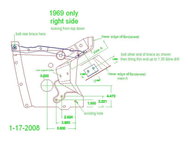

09-20-2010, 03:23 AM
bigtyme1
Join Date: Aug 2006
Location: Stewartstown PA
Posts: 1,777
I have a pattern for you,This is off Team Camaro same one I used. The main hole is about 2.5"
