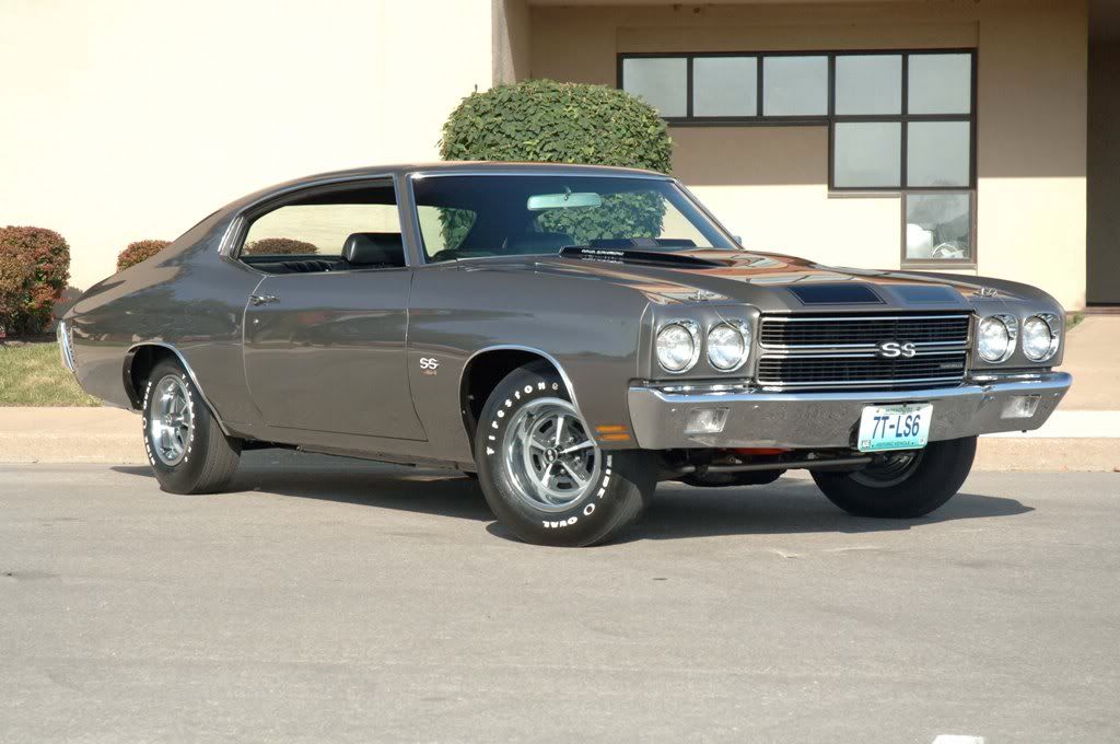

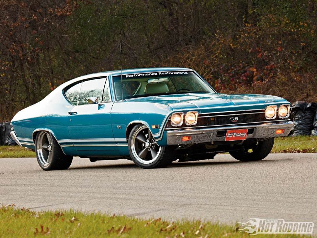

Tried to do a poor-man's manual photoshop for my '70 Chevelle build. Car is completely apart now, so I "borrowed" a photo from Google of another Shadow Gray '70 Chevelle, printed it out with a picture of the Jarvis '68 Chevelle as close to scale as possible, and cut & pasted the wheel setup onto the '70 stocker photo.
What do you think? I know the front wheel scale is a hair off (smaller than real life), but I think we have a winner - now if only I can find out from Team III if the wheels will clear my 14" Baer Pro-Plus brakes that are soon to arrive.
Stock
Jarvis' 68 with 18X11 305/35 & 18X9.5 275/35
My proposal:
I know the image quality is crappy, but I don't have photoshop or the skills to clip the wheels & alter the stance of the car digitally.

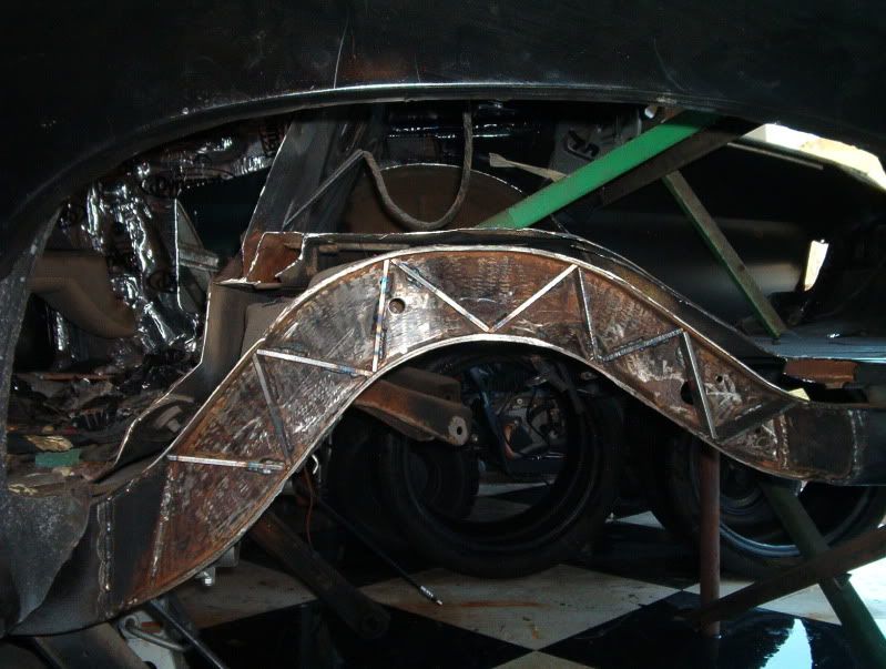

Here's my 70 Chevelle with a 2" strip in the inner fenderwells. But while your in there, go ahead and notch the frame in case you really want to go bigger, say a 345 series. And before I went this route, I had 17 x 11 wheels and a 315/35/17 with no modifications at all.
