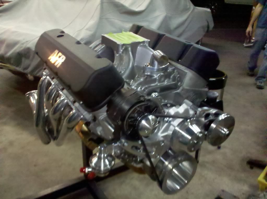

Motor is a 491 BBC....

Nice looking BBC!
What are the build specs? (cam, heads, carb, hp est)

wow very nice ! What pulley system did you use there ? Looking to do something similar for my 502 66 chevelle

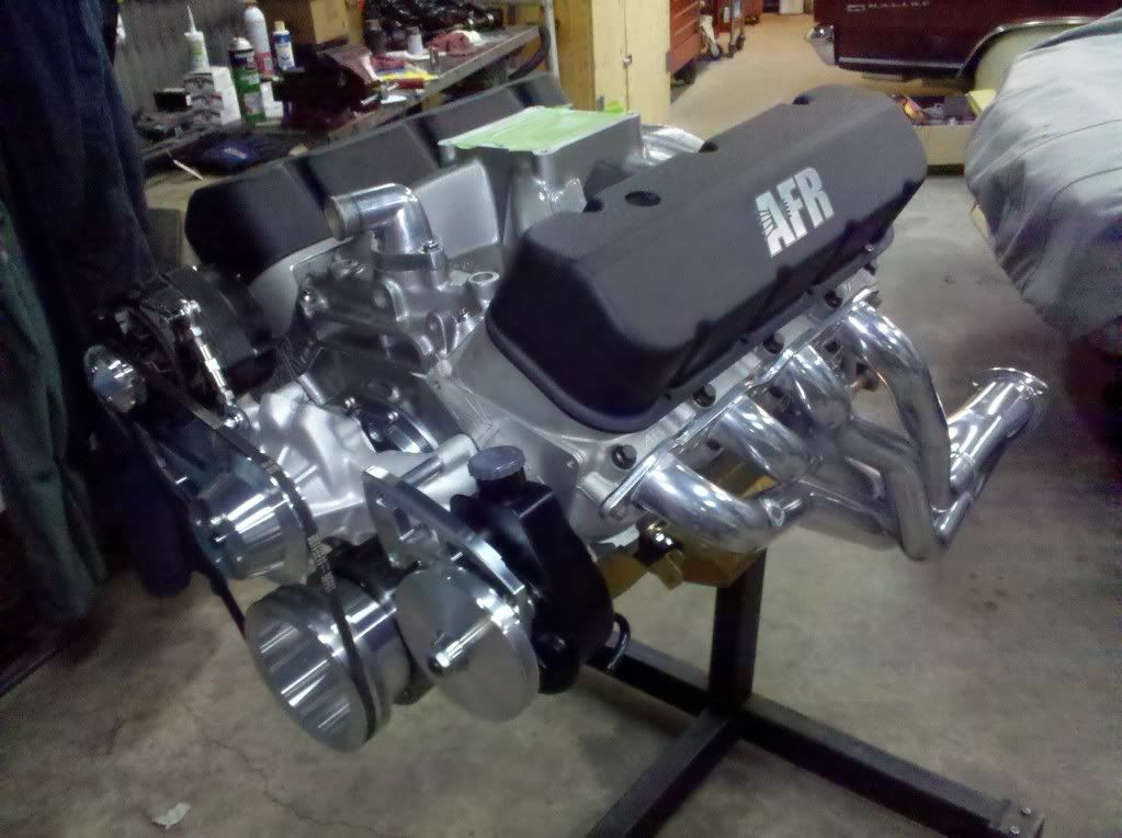

Thanks guys! Here are the specs
4 bolt 454 block
Scat 4.25 9000 crank
6.38 Scat 4340 rods/arp bolts
ICON forged +18 pistons.....approx 10.2 to 1
Eddy Vic Jr intake
Holley HP 170 GPH mech pump
Prosystems HP1000...(need to buy)
AFR 315's..full 100% cnc ported
Comp Ultra pro magnum rockers
Comp billet solid roller...286/292...248/254...692/660....110
Isky EZX roller lifters
Cloyes billet double roller chain
Cloyes billet cover
Eddy Victor water pump
Summit SFI balancer
Summit SFI flexplate
March billet ps brackets/alt brackets/pulleys
Hooker 2"x3.5" Longtubes..Jethot coated
MSD Probillet with vac advance/MSD 6AL-2 digital programable
Should make 650 HP or so pretty easy I hope.....

650hp She'll do better than that. With a single plane, AFR's, and that pro systems 1000, you will be knocking on the door of 700 ponies easy. Lookin good.

Ron, that looks great man. What a beast. And I agree that's a near 700hp recipe ya got there!
