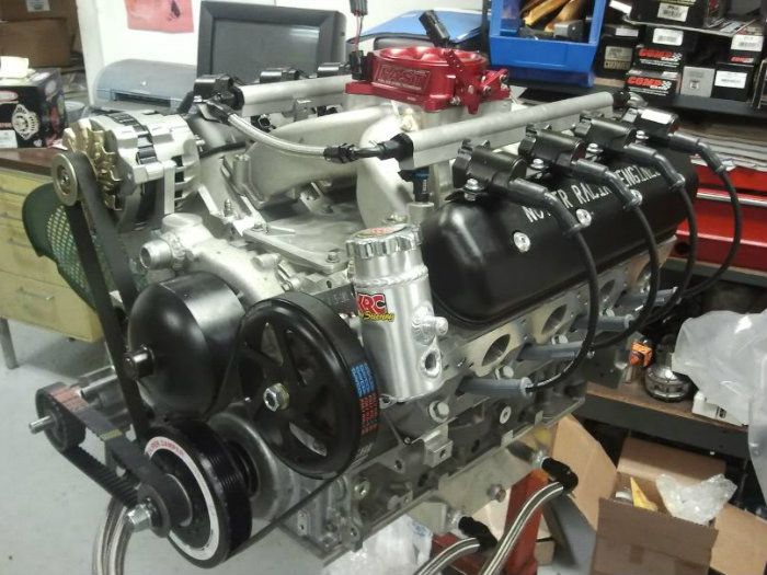

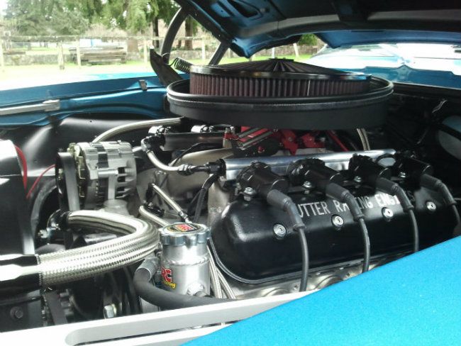

Here's the engine set up, Just got the engine installed this past August.
LS2 Sleeved aluminum block, 427ci, 4.125” bore x 4.0” stroke
LS7 CNC ported heads
Port fuel injected
FAST 4 barrel TB
GMPP LS7 single plane intake
T&D 1.8 rockers
247/255 @ 0.50 Cam, 112 LSA
Manley crank and rods
Weisco forged pistons, compression ratio 11.5:1
NRC 4 stage dry sump oil pump
Katech aluminum flywheel with ZR1 Corvette twin disc clutch
Vaporworx fuel system w/CTSV fuel pump (380lph capacity)
Kooks 1-7/8 headers
GM ECM
Pump gas

welcome, car and motor look great!!

on the motor, who or where did you get the alternator mounting from?

Nice eng. Nutter builds some nice stuff

Nutter Racing Engines built my engine complete... including all the parts for the front drive (alternator mt., PS mt. and dry sump pump mt.). The mounts are CNC billet parts and are very sturdy and well designed. They do a lot of stuff for LS engines.
