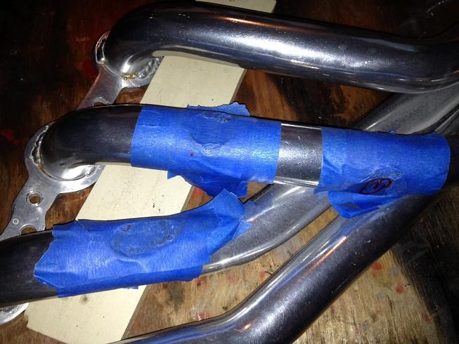

Originally Posted by huggerz View Post
I was more wondering about the fit. For that price I wouldnt feel bad if I had to "adjust" them. lol.
Yeah, I had the same feeling. I used those eBay headers on my LQ9/T56 swap into my '67 Camaro a few months ago. I'm using Dirty Dingo Sliders and an adjustable T56 crossmember from BMR. I figured I'd have enough adjustability to hit a sweet spot for clearance, but that wasn't the case.
I have a slight exhaust leak on the passenger side where it bolts to the heads (I think the flange is warped). And they had to be dimpled with a big socket and an even bigger hammer on the driver's side.
