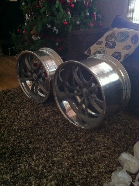

Alright, so the wheels finally arrived! My hats off to Chris Coddington and Hot Rods by Boyd! Took about a month and a half from when I ordered them till I got them and that includes a delay at the border, and the Christmas holidays! Ended up going with 6" backspacing in rear, 4.75" in front... 20x12 and 19x8 front:

Congrats on the wheels they look killer, especially for xmas.
I recognize the couch too looks like a Stylus.

Haha there's a very good possibility it is, but I'm going to have to claim ignorance on that! The gf gets the house, and I ask no questions, and I get the garage and she asks none... It's a good compromise in my opinion lol!
