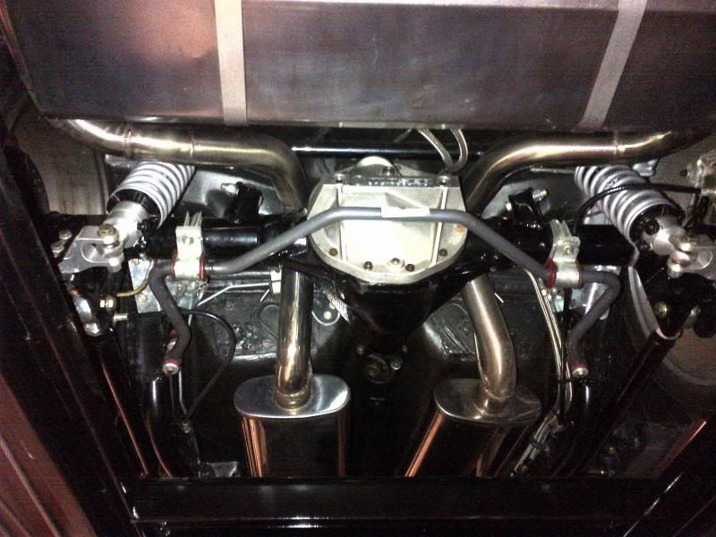

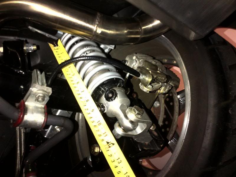

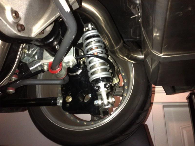

Here is my setup with a shorter spring. I'm not sure if the the shop that did the install used 8" or 10" springs but I measured and photographed them compressed.
https://lateral-g.net/forums/show...&postcount=385

Rybar thanks for the pics,i've searched a lot of threads on this and it seems that some have used the 8in spring and it worked fine may just try it and see, if it doesn't work out want be the first time I've made a mistake with this build LOL.Btw love your car it's a work of art for sure,man i wish could get a pair of those tailpipes guessing they were made in your part of the world.THANKS!
NP glad I could help out I wish I knew this before buying my setup. Yes the tailpipes were custom made locally. The tank is a stock width Ricks tank that is not dog eared on the corners. So for those wondering it can be done, this is with 2.5" tailpipes though.
