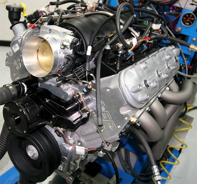

The STOCK LS2 with the stock heads, intake, cam and all that was hooked up to the engine dyno today.
Only "upgrades" were some Hooker 1 3/4" long tube headers since we had no way to hook up the stock exhaust manifolds.
After some tuning we made 462HP .. this on a motor that's rated at 400hp..
Then we took off the Hooker headers and bolted on the 1 7/8 stepped race headers from 21st Century Street Machines ..
472hp!
Picking up 10hp from a header swap is great.. and we lost nothing on the top end. the 21st Cen headers gained from about mid pull all the way to the top..
Then we bolted on some AFR 205 heads and will make that pull in the AM. After that the cam then the FAST intake..
Anyone wanna guess the final number?

That is impressive to say the least, 72 HP over the rating. What is on the agenda as far as engine mods that will be used for the final product?
Total mods:
AFR 205 heads (larger valves, double springs, Ti retainers)
FAST 90mm intake
COMP 230/232 114+12 cam
21st Century Street Machine stepped race headers (already on engine)
That's it..
